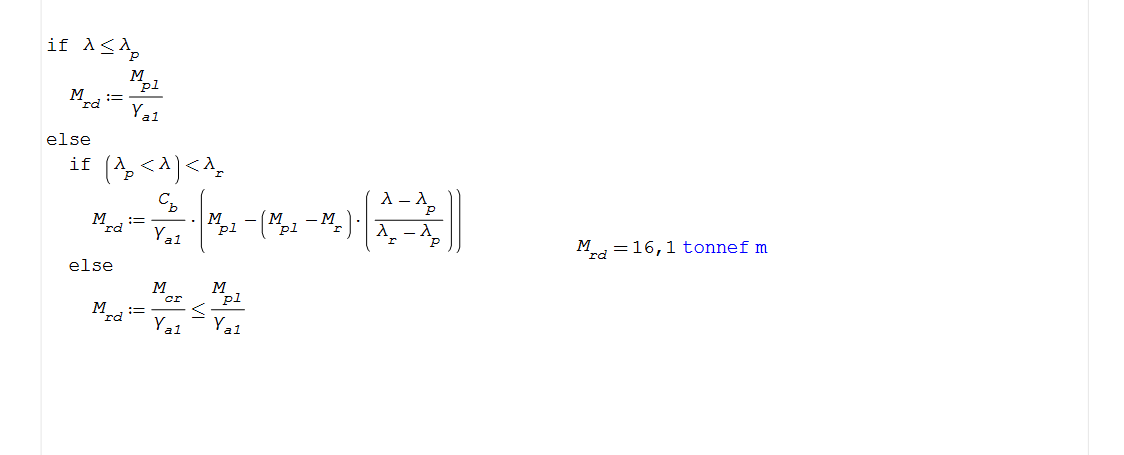

Hello everyone.
I have an If shown in the image below. I would like that in addition to the result of the equation, it would also be shown from which equation the result originated.
It is possible?

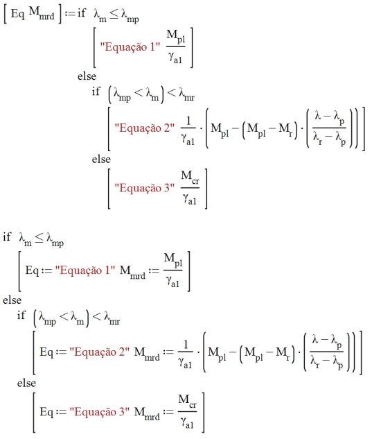

Leandro, for example like this:
Leandro.sm (7.13 KiB) downloaded 1223 time(s).
As Jean says help us get help and always attach the smath file with the problematic example.
Thank´s so much Sergio. It´s Works very nice.

Hi. Those are very similar to the Sergio (Pompelmo Tell) solution:
