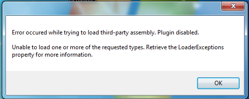

Okay. I was able to update SMath Desktop to 0.9. When it launched I get the following error dialog. That because some of the plugins were developed for 0.89 Stable.
I removed all the old plugin, leaving only those dated 1/10/12 and it works. The developer is going to have to update their plugins and post for distribution.
