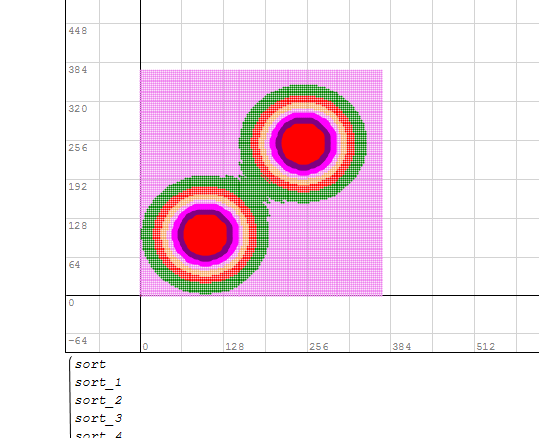

Hello all. This is my case. It runs dramatically low. Can anyone give a hint for increasing speed? Or such a situation is normlal. Thanks.Postroenie polja riska.sm (148.07 KiB) downloaded 1163 time(s).

Select all regions and put Optimization->Numeric

Great! Fantastic! I was nearly diappointed, but it is really TOOL.

Much different stuff ... you can shift another set,
as well as plot in a random filled square.
Too long to resume in my laptop.
Circle Magic Disk.sm (27.28 KiB) downloaded 1196 time(s).

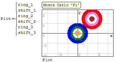

#16 Posted: 2/28/2020 10:21:58 AM
As interpreted ... ?
1. You can have as many rings as desired, sizes as well.
2. It may be profitable to transit/spool to file.
3. You may have in any Web colors from otherwise construction ?
4. Rectangle may be added ?
Circle Monte Carlo.sm (24.04 KiB) downloaded 1132 time(s).
#17 Posted: 2/28/2020 11:40:50 AM
2 confirmations:
1. Spool to file YES for recovering from other document.
2. Web colors YES from code ... somewhat greedy !
Circle Monte Carlo.sm (32.22 KiB) downloaded 1153 time(s).
#18 Posted: 3/2/2020 5:43:34 PM
... a much faster version.
Circle Monte Carlo.sm (33.97 KiB) downloaded 1148 time(s).
