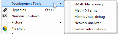

menu: Insert > Development Tools
SMath file recovery: fix *.sm files with corrupted/unhandled XML structure (unexpected ending, corrupted color codes, title self-closing tag);
Math ⇒ Terms: converter to see/build C#/VB.NET code from SMath math (plain text);
Math's visual debug: to see Term dependancies and lacks;
Network analyzer: to test your network;
System informations: get the main hardware/software infos;
Plugin's folder: open the current assembly location of installed plugins;
SMath Studio 0.96.5146 or later required
