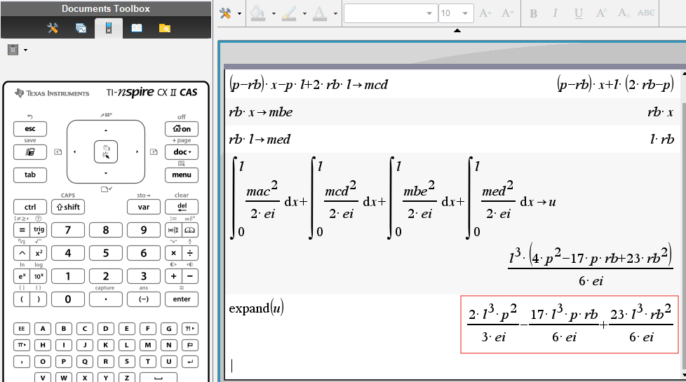

Hi. I'm using Ti Nspire cx cas. And I knew this wonderful smath studio program!
In Ti Nspire, when I want to expand a equation, I use expand() function.
But in smath studio, I couldn't find expand() function.
How can I do this, for example, the equation is
(x+y+z)^6

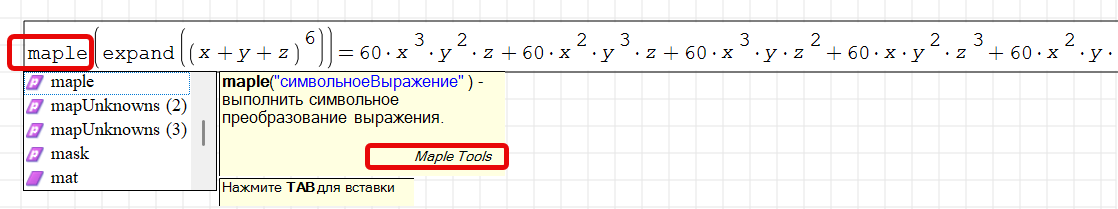

#2 Posted: 12/6/2025 4:34:22 PM
1,554 likes in 1,864 posts.
One way is to use the maple() function (MapleTools plugin).
3 users liked this post
sergio 12/6/2025 6:39:56 PM, kimkim 12/7/2025 3:51:16 AM, ioan92 12/11/2025 8:10:13 PM

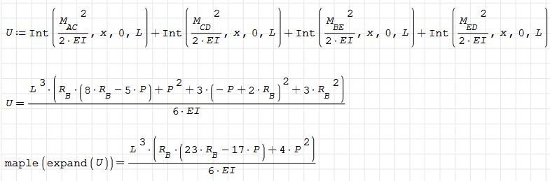

Thank you very much. I could expand my equation like below.
one more question please..
Can I expand it in smath studio like in my Ti nspire result?

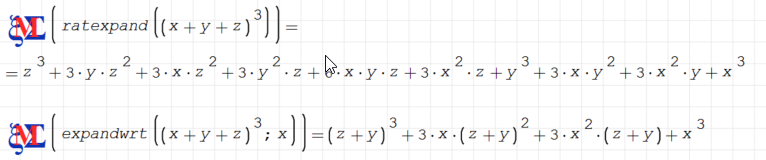

#4 Posted: 12/7/2025 12:11:01 PM
1,356 likes in 2,271 posts.
Maybe, you just have to switch Optimization> None in the context menu. SMath's symbolic "optimization" sometimes rolls back external expansion with Maple or Maxima.
Edited 12/7/2025 12:15:00 PM
