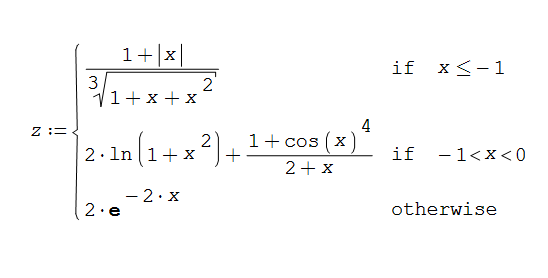

How to make a condition to the right of the equation, as shown in one of the figures

Use the cases() function. By default, cases() show only two instances. For create new ones, please refer to this post
For define the interval -1
cases.sm (3.84 KiB) downloaded 1480 time(s).

there are 3 options:
1. use "cases" function
2. use "if" function
3 use algebra with some range
learn how to use conditional range will helps alot. (download cutom functions plugin and the shortcut is ltlt lele lelt ltle gtgt gege gegt gtge)
just picture
options.sm (10.41 KiB) downloaded 1486 time(s).
From conventional codes ... short extract.
Under the hood, ltlt is complete Bolean.
Integrate Discontinuous [min(x)] OTHERWISE ltlt.sm (10.7 KiB) downloaded 1341 time(s).
