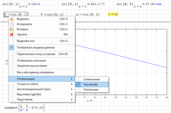

See please the attach.
n<=21 - all OK!
n>21 - not OK
Why?
TubeMChS.sm (66.92 KiB) downloaded 1430 time(s).

Указать численную оптимизацию.

#3 Posted: 7/14/2023 4:09:23 AM
Valery Ochkov
Valery Ochkov
67 likes in 716 posts.
Спасибо!

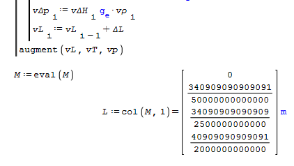

... И много таких подводных камней в SMath?
Hi. That's not SMath pitfalls. It's a feature: SMath remembers the intermediate steps of what it's calculating, unless you tell it to forget them, with eval. This also usually speeds up the following steps.
