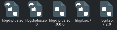

This happens because libgdiplus in appimage has missing symlinks.
I added and recompiled appimage with libgdiplus symlinks added.
Now it works. I don't know why Andrev didn't add those links, who knows?
Download appimage linked below, I have tried with linuxmint_22 live iso.

I did extract content of original smath appimage from terminal via --appimage-extract argument.
Added libgif.so and symlinks for libgdiplus.
Mono library replacement shouldn't be necessary, only for just in case.
Andrey, you can take my appimage and extract its content.
Only smath file updates should be enough for new appimage creation.
#9 Posted: 12/24/2024 12:42:14 AM
599 likes in 1,381 posts.
Generally libgdiplus library is strictly depended on glibc version of system.
Usually it is creating the havoc, because of it also mono libraries too.

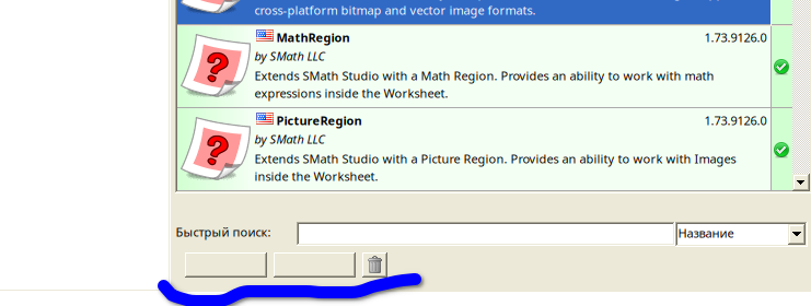

This should work now, please check it and report
it works even with XYplot plugin)
But some text can't be imaged like in the previous version

For the lacking of button texts, it is probably mono error.
Possibly I can't do anything about that.
