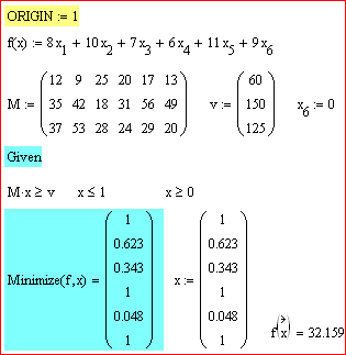

Is there in SMath some tools (plugin) as Given...Minimize/Maximize in Mathcad?

The Plugin is called 「Custom Functions」 by Davide Carpi; there you have Min() and Max() as they behave in Mathcad.

you might check here: https://en.smath.com/forum/yaf_postst20261_function-maximize-minimize--in-Smath-Studio.aspx

From Smath Forum.
minimizerExamples_Kr.sm (38.37 KiB) downloaded 1344 time(s).
minimizerExamples_Kr_2.sm (38.37 KiB) downloaded 1330 time(s).
minimizerExamples_v01.sm (39.64 KiB) downloaded 1336 time(s).
Maths Simplex_Minimizar_Example_3.sm (139.88 KiB) downloaded 1380 time(s).

Hi. Also you can see Lagrange multipliers with Draghilev's method and Mathcad solve blocks here: https://en.smath.com/forum/yaf_postsm80940_Mathcad-Toolbox.aspx#post80940
