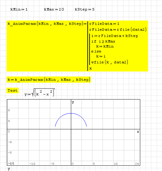

It is really a must . The program is increasing in capabilities and I guess that a lot of people is developing functions that facilitates some calculation ( or animations ) like the one below reported ; but is frustrating that is not possible to recall them easily .
