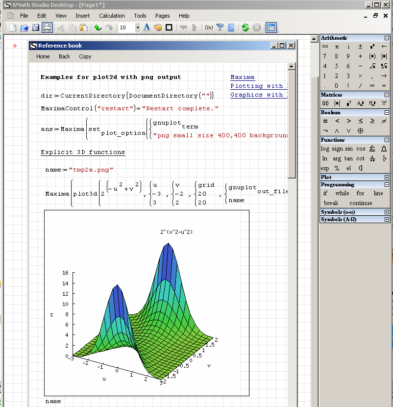

The attached screenshot is done with the Maxima plugin from SVN installed. This shall be released to the gallery tonight.

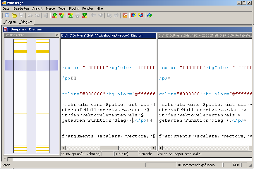

There is a formatting issue in the interactive book.
Andrey, something happened to the line termination characters. This seems to irritate the text region. Also, some math regions changed size, but that does not seem to be problematic.
See the text formatting in the attachment. The original version has a german SVN time stamp, your version has a russian one.

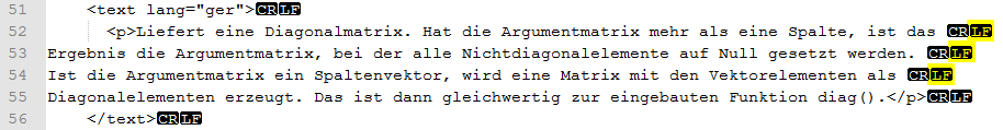

This happens when the text region contains line feeds. Because the files produced by Andrey contains both carriage returns and line feeds, I suppose is a problem related with the text editor that has used. (A file generated in UNIX systems looks like the first shown here)
2014-02-10 16_17_36-C__Users_Davide_Desktop_SMATH_handbooks_Activebook_activebook__Diag.sm - Notepad.png

Problem resolved. I reproduced the changes made by Andrey using FAR. Both PDF and interactive handbooks are now up to date in the online gallery.
