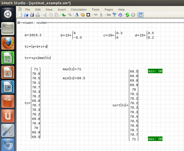

#6 Posted: 7/30/2012 8:34:43 AM
HI
Thanks w3b5urf3r,
but then I have the same question as in the beginning of this thread: how do I get the min / max-value of this result?
example
(btw how did you enter the preview of the live file in your post?)
For the max() and min() values use the snippet sys2mat() in the attachment
To show the preview click on "Get link..." in the bottom-right corner of Live SMath and copy&paste in your post the 2nd link
best regards,
w3b5urf3r
sys2mat_example.sm (11.4 KiB) downloaded 1540 time(s).

#8 Posted: 7/30/2012 11:37:16 AM
Here is a screenshot from Ubuntu 12.04
No errors reported.

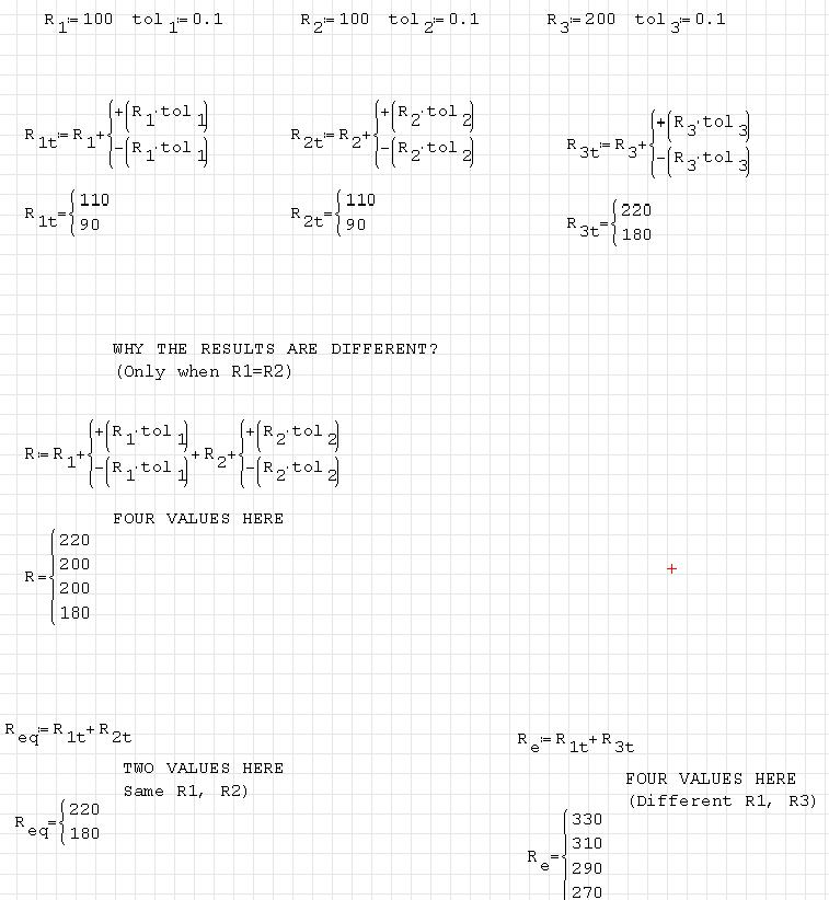

Why I am getting different answers?
(http://www.yourfilelink.com/get.php?fid=816752&dv=1)
Tolerance
Thanks,
Basile

#14 Posted: 7/31/2012 10:50:24 AM
Basile
Basile
8 likes in 172 posts.
Here should be...
#15 Posted: 7/31/2012 12:14:00 PM
Here should be...
it's the optimization in the definition of [MATH]R[/MATH], [MATH]R,eq[/MATH] and [MATH]R,e[/MATH] (see optimization of coloured equations in the attachment)

#16 Posted: 7/31/2012 12:19:38 PM
Pay attention how sys() is working. In this simple example, every element from both sys() are combined with each other:
[MATH=eng]sys(1,20,2,1)+sys(50,300,2,1)=sys(51,70,301,320,4,1)[/MATH]
Sometimes it behaves differently, it depends on optimization applied.
Optimization numeric:
[MATH=eng]sys(1,20,2,1)+sys(1,20,2,1)=sys(2,21,21,40,4,1)[/MATH]
Optimization symbolic:
[MATH=eng]sys(1,20,2,1)+sys(1,20,2,1)=2*sys(1,20,2,1)[/MATH]
Actually: [MATH=eng]2*sys(1,20,2,1)=sys(2,40,2,1)[/MATH]
To be honest, because sys() in the calculations can sometimes be quite confusing, my advice is to avoid it in calculations. Actually, I did not figure out yet where the sys() environment is the most useful for using - excluding plots.
