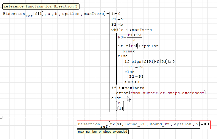

Hi everybody,
Please, are there some examples for the use of error function ?
Ioan

Hi everybody,
Ioan
See the attachment
regards,
w3b5urf3r
EDIT: new wiki page for error added

Thanks a lot w3b5urf3r,
Best regards,
Ioan
