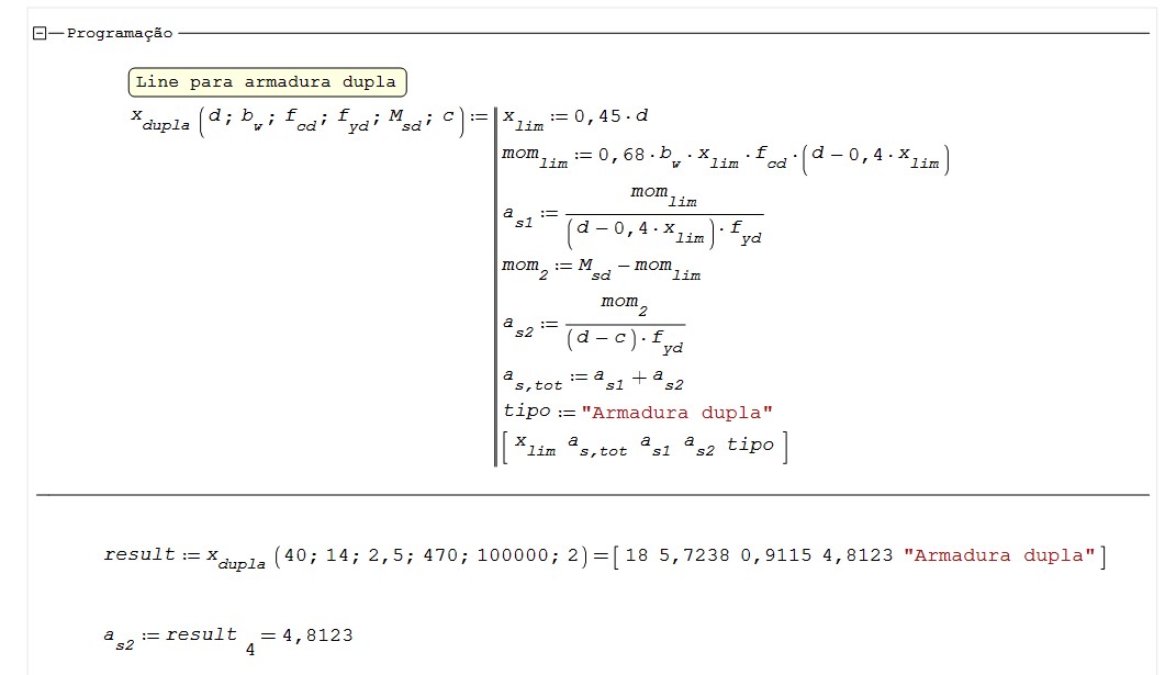

Hi! I have a user-defined function line that I want to keep inside a specific area. Outside this area, I want to display the results, including the equation. In the example, I want "As2" to show the equation (inside the line) and not just the result. Is there a way to display the equation outside the line as well?
Thank you !
