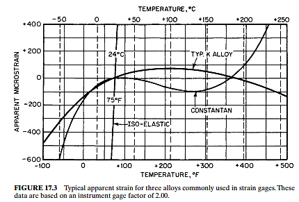

If you purchase strain gauge, they come with the corresponding factor
and if applicable the reading equipment will compensate for temperature.
What I understand: you are experimenting some strain gauge material
simulating some real application. In that case, from the experimental
data as collected, you want a model function and the best representative
fit to the data. Then, only the data are needed.
If you just have a graph from the lab test, that's good enough.
