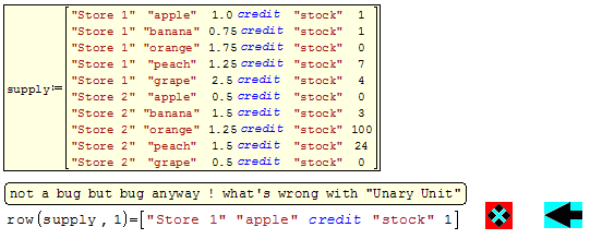

#1 Posted: 3/6/2018 11:15:32 AM
No logic in that observation.
How can I explain if I can't explain to myself ?
Utilities Matrix [Parse Lookup, Truth Table].sm (26.37 KiB) downloaded 1105 time(s).

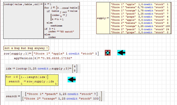

#4 Posted: 3/6/2018 1:54:40 PM
CBG
CBG
78 likes in 312 posts.
Hello Jean
The version "0.99.6638.17192" of Smath Studio does it correctly.
I also propose a small change in the variable "Search"
#5 Posted: 3/6/2018 10:39:33 PM
Thanks Crlos,
Your'e right: just search for what is demanded.
