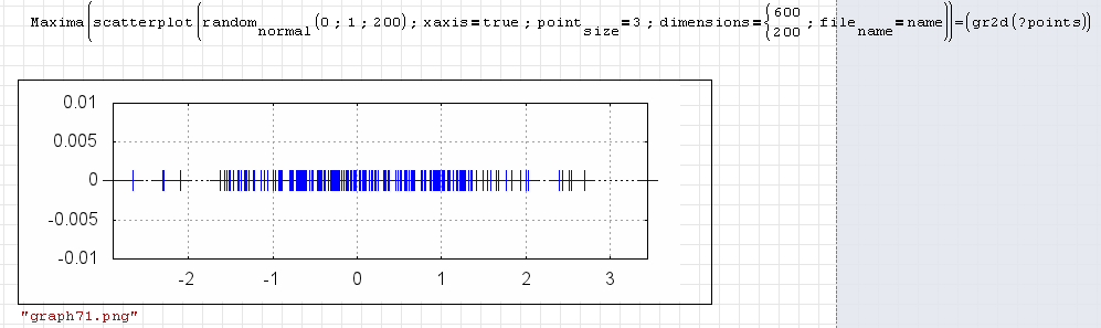

Plugin updated.
Changes/Features:
- List and matrix translation improved, mixed and nested arrays now supported
- arcus and area functions are correctly translated
The changes improve the access to many functions in Maxima, which require mixed
or nested list/matrices as input or produce such output.
Also, note that the example shows how to produce scalable svg with the draw
package.
Extended doc in SVN and update of inofficial version coming soon...

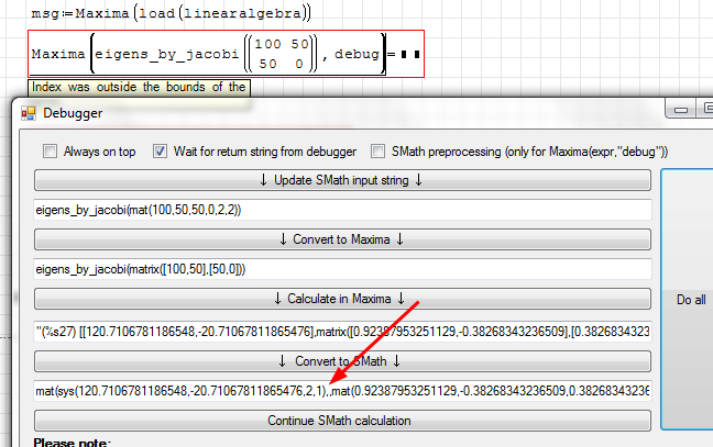

I just tried your example file. It crashes my SMath, but never mind. I copied parts of your file into another one to see what causes the problem.
I just wanted to thank you for stats package. It seems it is working
. The results are put in the system as you presented in your example.
Resizing of svg plot example is working for me as well. At the moment I do not know the details of it and how to use it for other plots using draw package, but never mind - I will figure it out sooner or later.
It seems that the problem and crash of SMath appeared just at the beginning of your example (linearalgebra regions also did not produce output). I copied the regions and "stack empty" errors appeared sometimes, sometimes crash happened. It does not look that those regions should cause problems. Actually, only by disabling the calculation of the first two math regions in your example (these first two like in the picture will suppress the SMath crash - calling functions from linearalgebra will still fail).
See the picture and the log file please.

#45 Posted: 1/2/2014 7:01:04 PM
Radovan, thanks for the feedback.

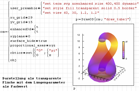

Here is a preview on how graphics could be supported in the Maxima plugin. In the attached sheet, the functions Draww2D() and Draw3D() are defined.
They take a list of options and objects as first argument, the output file name as second argument and optionally a two element list or matrix as size specification (defaults to 300x240 pixels).
Filenames can be given with .svg or .png extension, the output format is set accordingly. If no extension is given, it defaults to .svg. The functions return the actual name of the produced output.
For display, image regions are used. If the image region would evaluate the file name expression, the complete command for making the plot could reside in the placeholder and eventually be hidden. For now, the file name must be assigned to a variable and that variable must be put in the placeholder of the image region.
The attached sheet contains snapshot regions, as it was made to produce images for the pdf-handbook.
The examples in the attached sheet are mainly from the Maxima-Handbook, but also from the Plot3D plugin by uni (Klein bottle). The screenshots show the complete code required to produce the plots (except init like setting current dir to document directory and eventual reset of Maxima incl. loading of the draw package.
After some playing around and eventual feedback from the forum we shall implement the proposed functions in the Maxima plugin. Feel free to test and propose improvements.

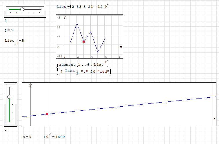

Hmm...I can not find the Slider Region in the Extensions Gallery. Where it is? It is made by Davide but I could not even guess the password this time (as I usually do)?
#52 Posted: 2/11/2014 5:07:26 AM
WroteHmm...I can not find the Slider Region in the Extensions Gallery. Where it is? It is made by Davide but I could not even guess the password this time (as I usually do)?
Don't worry, will be relased ASAP :d

I deactivated the sliders in the example. No need to ask the NSA for the password, it is not that strong. However (Davide, forgive me), I might trade it against hints on how to use the modeller region ;-)
