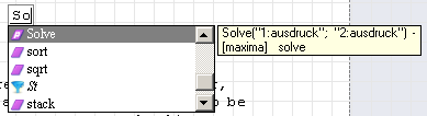

By the way, I can not understand how Solve() worked in your example. I should use Maxima(Solve(...
Doesn't the dynamic assistant show the Solve() function? It should work without wrapping it in the generic interface function Maxima(). In fact, Solve() is an SMath function defined in the Maxima plugin which does nothing but call transpose(sys2mat.1(Maxima(solve(...)))).
Maxima(Solve()) calls Solve() in the process of preprocessing the Maxima() function and then drives the result to Maxima and vice versa, just to prove that the translation process is robust enough ;-)

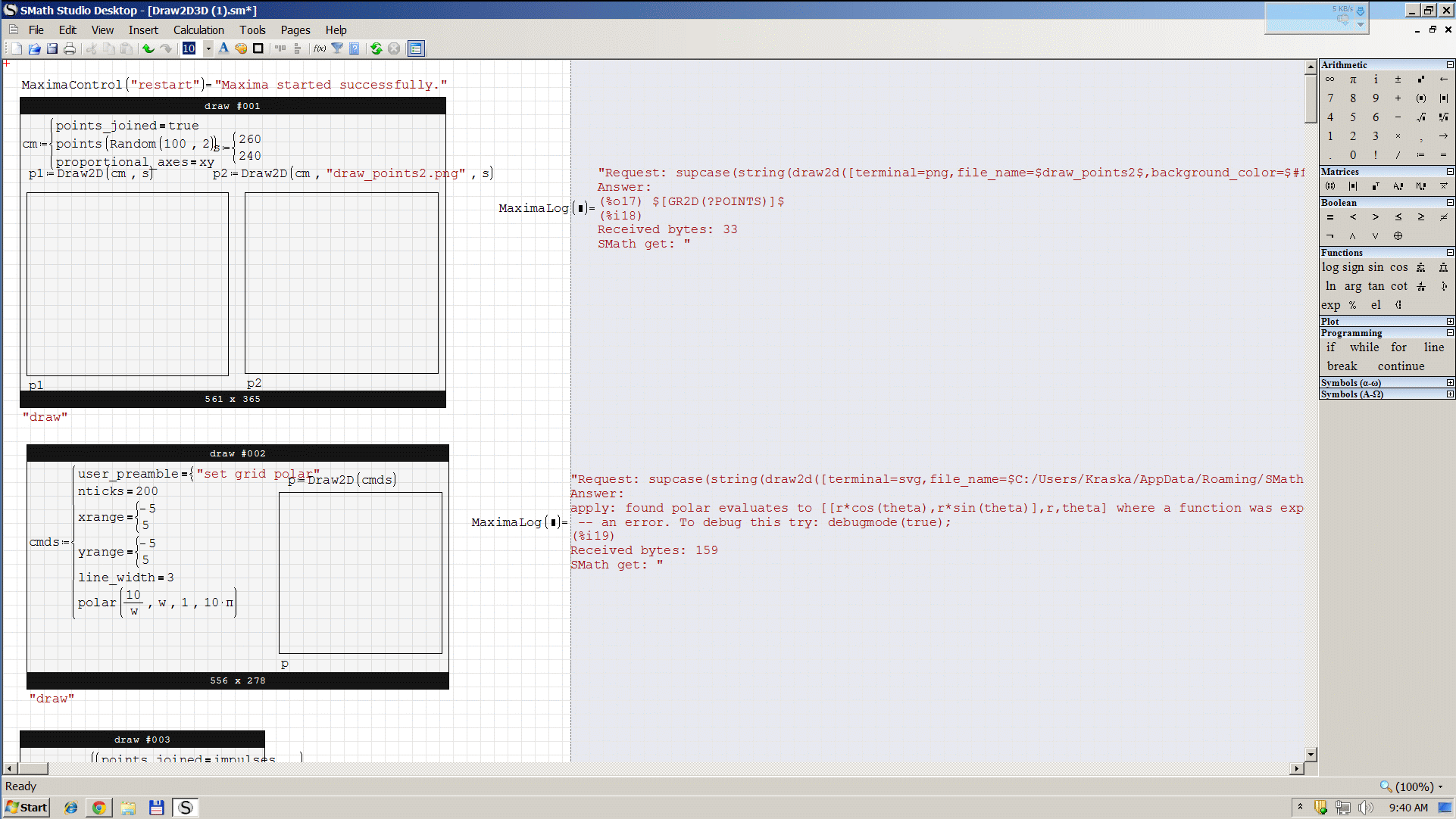

#72 Posted: 2/27/2014 10:52:14 AM
Igor Skarine
Igor Skarine
14 likes in 97 posts.
Hi Martin,
I'm sending a screenshot for the test, you provided.
#73 Posted: 2/27/2014 2:16:28 PM
1,361 likes in 2,275 posts.
Hi Igor,
the first two plots shown should in principle work, the third plot shows the same error message as on my system. There is some problem with the function polar() in the interface.
The log message for the second plot looks fine, there should be a file of the name specified in your system. Try to search for it.
Maybe, there is a path issue? Try to add CurrentDirectory(DocumentDirectory(""))= to the sheet. Or try to launch it by clicking the sm file and alternatively, opening the file from a running system. Any differences?

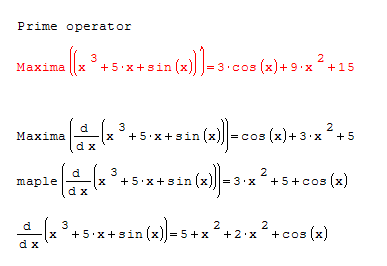

#80 Posted: 3/11/2014 4:01:56 PM
Am I missing something here? Maxima prime operator diff(1) does not give the correct answer.
Martin Kraska 3/11/2014 4:56:00 PM
