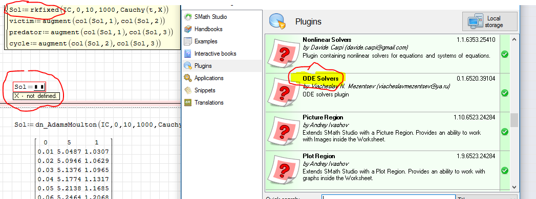

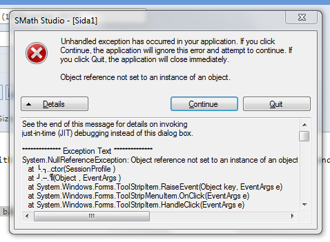

Bumped into the problem of ODE Solvers plugin and the recent build. Started the example for ODE solving from the Martins's Reference book. Tried to delete and reinstall ODE Solvers, example started once and but the problem persisted after the second run.
#22 Posted: 11/11/2017 10:37:38 AM

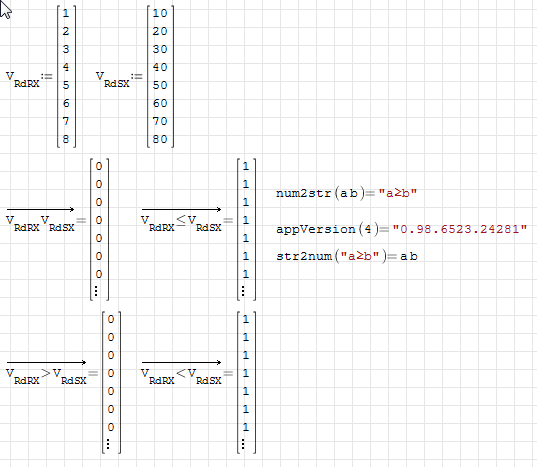

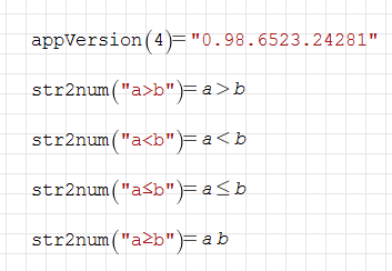

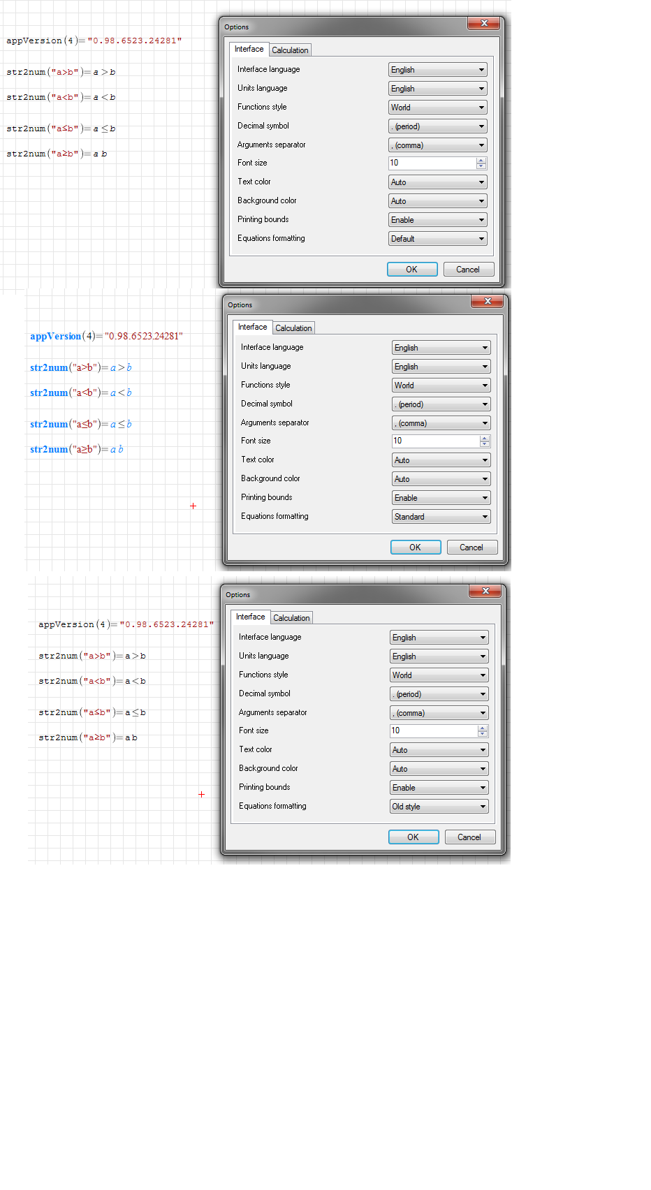

WroteThe reported problem persists (post #11), but it is specified that it is only for the >= and not for <=, > , <.
Hello.
Unfortunately I can't reproduce an issue with >=. Could you please doublecheck? Version is 0.98.6523.
boolean_check_1.sm (5.58 KiB) downloaded 1449 time(s).

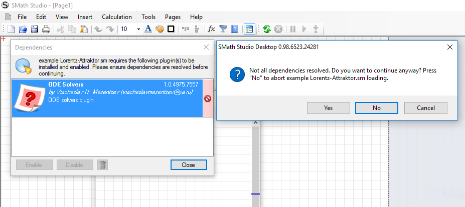

#25 Posted: 11/11/2017 5:33:55 PM
WroteBumped into the problem of ODE Solvers plugin and the recent build.
Just say "Yes continue" and open the work sheet.
Done otherwise: double click on the file from it's location,
"Yes, continue" it should open the work sheet all functional.
ODE Predator Prey [rkfixed Cauchy].sm (7.52 KiB) downloaded 1355 time(s).

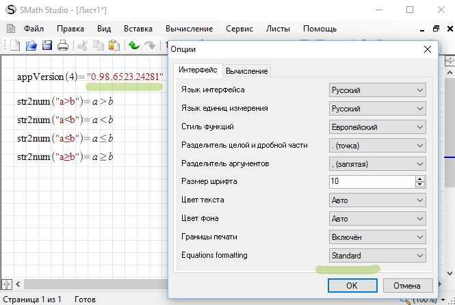

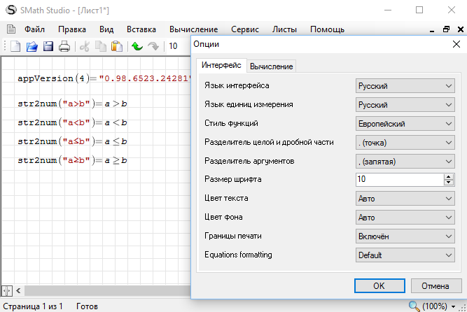

#26 Posted: 11/11/2017 11:11:07 PM

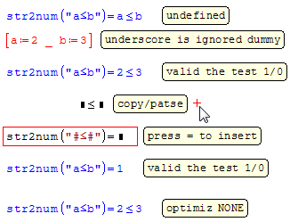

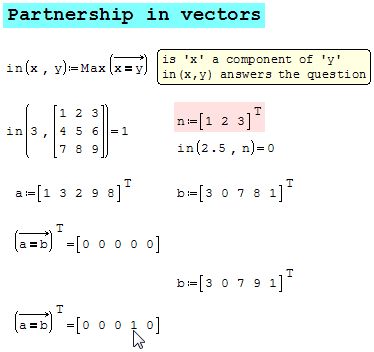

WroteHow about indicating the formatting scheme (e.g. in the status line)?
Bolean should be specified completely. The example > ... < is trivial
If not specified completely, all sorts of error messages will be issued.
Mathcad was more tolerant, thus much less educative than Smath.
DeBoor argument v< ... is however completely specified wrt to its neighbour
if((el(u,μ)≤v)&(v
Vector Maths.sm (1.06 MiB) downloaded 1649 time(s).

#29 Posted: 11/12/2017 4:03:33 PM
WroteWroteBumped into the problem of ODE Solvers plugin and the recent build.
Unfortunately, this will not work for me (Windows 10, 32bit)

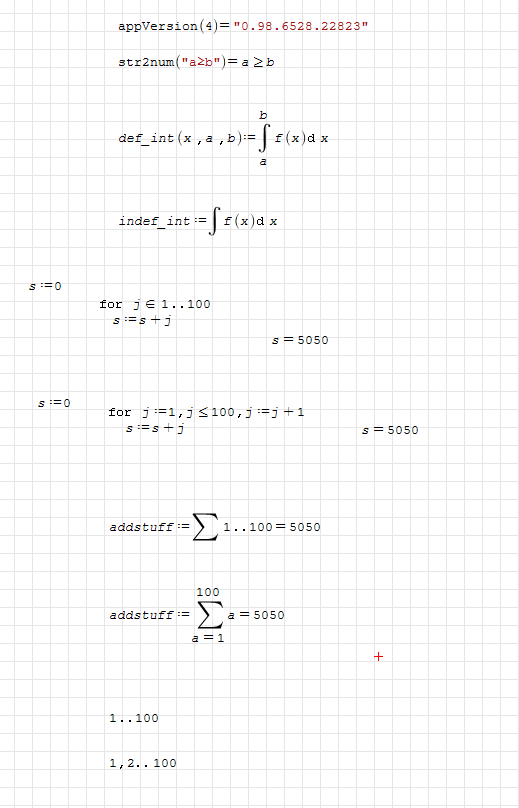

#33 Posted: 11/15/2017 6:02:43 PM
Thank you all for your comments!
Topic updated - new SMath Studio 0.98.6528 released.
New visualization approach improved again. The main change is that support of Linux restored and "more or equal" operator should be fixed now. Also, the following functions looks much better now: int(2), int(4), for(3), for(4), sum(1), sum(4), product(4), range(2), range(3). On Windows operators do not look blured anymore.

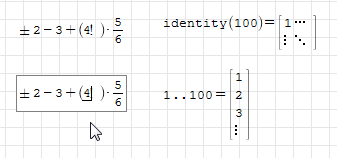

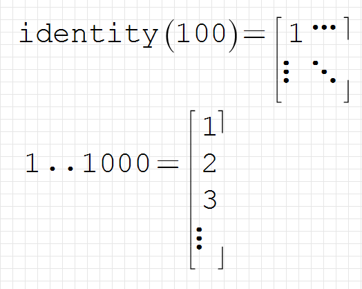

Better
A couple of issues I still found: horizontal alignment of factorial and vertical ellipsis
![2017-11-15 00_27_40-SMath Studio - [Page1.sm_].png](/en-US/files/Download/C7pmoy/2017-11-15-00_27_40-SMath-Studio---[Page1.sm_].png)
Broken right bracket of matrices changing font sizes (starting from 16pt):
![2017-11-15 00_19_21-SMath Studio - [Page1.sm_].png](/en-US/files/Download/aadUMM/2017-11-15-00_19_21-SMath-Studio---[Page1.sm_].png)
EDIT linux still not working for me

#40 Posted: 11/16/2017 8:09:38 PM
![2017-11-11 15_09_08-SMath Studio 0.98.6523 - [boolean_check_1.sm_].png](/en-US/files/Download/ySKQzw/2017-11-11-15_09_08-SMath-Studio-0.98.6523---[boolean_check_1.sm_].png)
