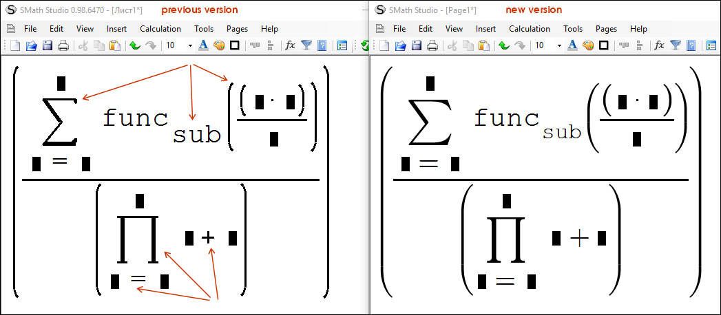

  • SS-174 Equations rendering logic rewritten to use vector-based drawing for operators and parenthesis to implement better quality of visualization and printing;
  • SS-48 Added ability to configure formatting of every type of the equation entries (font, size, color, etc.). See "Tools" > "Options" > "Equations formatting";

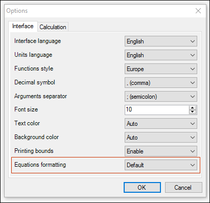

  • Added ability to accept Enter button as a selector of suggested value within Dynamic Assistance list if user explicitly did a search within a list using mouse or keyboard;

The new formatting options look promising.
Is there a reason for having all fonts downscaled to 80% in the pre-set configurations? I feel like compensating this by changing the font size to 12.

It is just because of diference between fonts: Arial and Courier New. Arial looks more tiny and a bit smaller. But one of the main changes is that now SMath Studio fully supports all kind of fonts to be used in equations, so you can choose any other one you like (it can be done altering C:\Program Files (x86)\SMath Studio\representation\settings.prop file with notepad) or increasing font-size (you can set size=120% f.e.).
In future I will provide UI of such kind of customizations, but for now I need to fix several issues related to new approach of rendering equations.
Thank you for the comment!

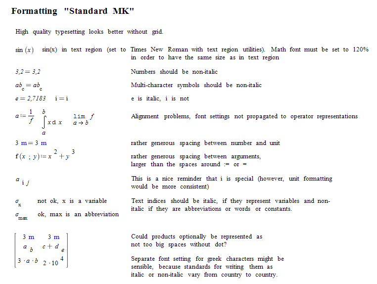

What is the idea about keeping smath sheets consistent between users? The same document can have totally different appearance if the users have different formatting settings. If I scale the fonts up to keep them readable this might create overlapping regions if they were created with different settings.
Will there be a choice to make the settings being part of the document? Perhaps with the option that any other user can deliberately override it with his own settings. But then he is in charge for any mess created.
A short test showed the following issues (some of them might be matter of taste). I understand this is work in progress...
formatting.sm (5.5 KiB) downloaded 1671 time(s).
EDIT: The functions are deliberately set to italic in "Standard". Thus this can be fixed using a custom style.

I felt encouraged to play around a bit. I wonder why the font in math regions must be scaled to 120% to result in the same font size as in text regions of the same font.
Perhaps we are entering an era, where people become more picky about appearance issues of SMath sheets. The monospaced text regions become inappropriate now...

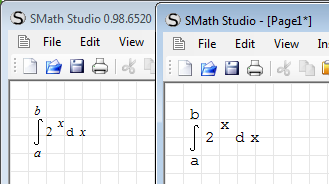

I encountered the following visualization problem in the use of vectorize (equations formatting: Default, Old Style, Standard)
[albumimg]1464[/albumimg]
Davide Carpi 11/10/2017 8:17:00 AM
#12 Posted: 11/10/2017 8:27:07 AM
Seems that the boolean operator "greater than or equal to" is not drawn, unrelated to vectorize

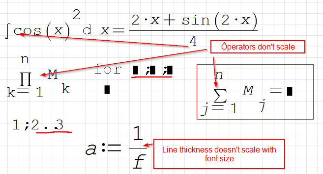

I experience some horizontal misalignments (caret position, empty placeholders, ...), I am the only one?
frapuano 11/10/2017 10:02:00 AM, sergio 11/10/2017 8:42:00 AM

Topic updated: new SMath Studio 0.98.6523 released.
Many improvements done for equations visualization, restoring of performance on calculation and new functionality requested by [USERLINK]Jean Giraud[/USERLINK] implemented.
Please make sure you are using Default equations formatting (in Options dialog) as this preset is now priority 1.
Note: Linux problem is not handled yet.

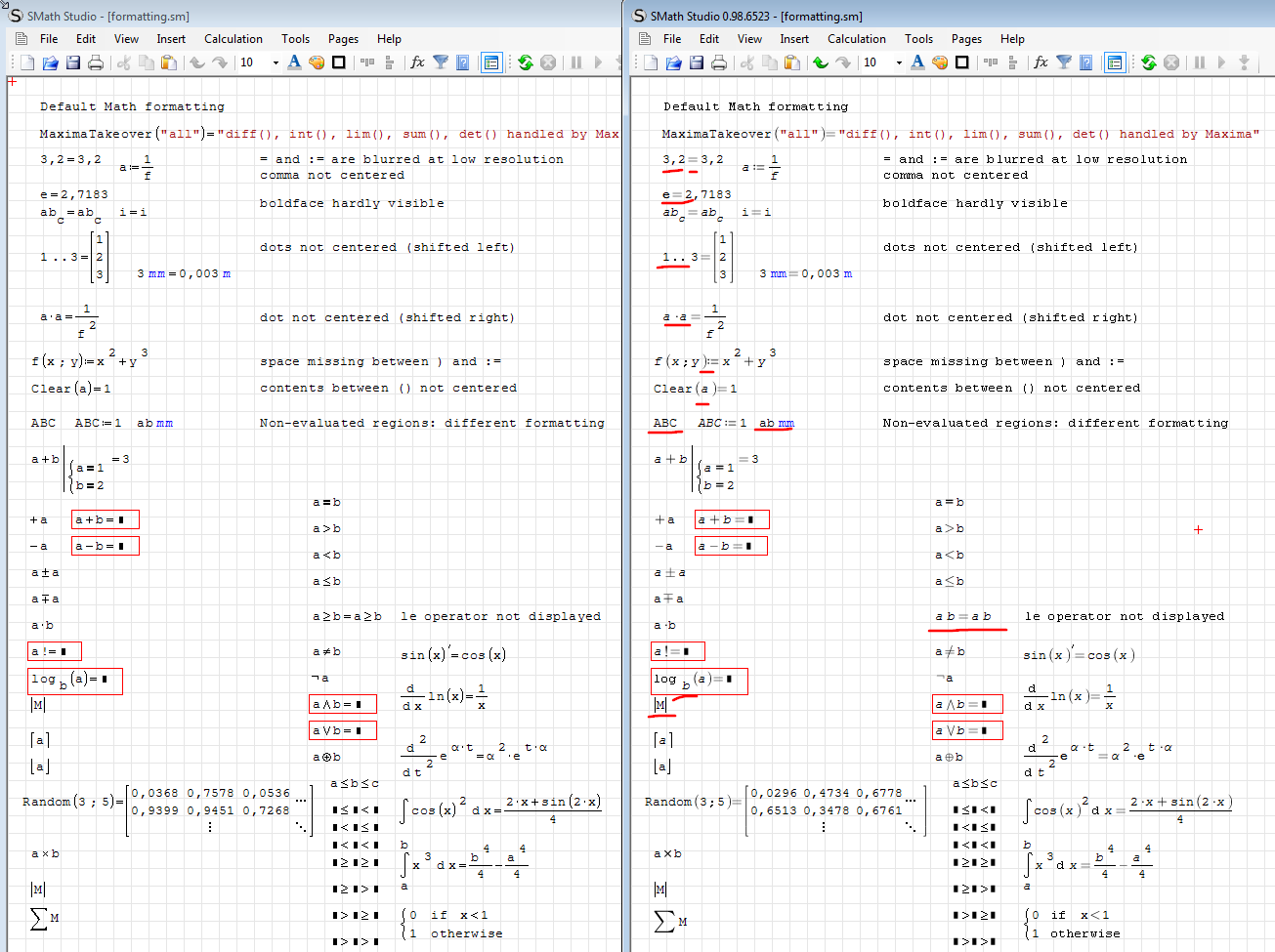

At low resolution/small font size, the old formatting is easier to read, mainly due to the blur of the thin-lined operators.
Pasting multiple regions as image is nice.
When the maxima-plugin is downloaded from the gallery and the offer to search for Maxima is confirmed, then the setup dialog automatically closes instead of waiting for user input. The dialog can only be used after next start of SMath.
Feature proposal: pan the canvas by drag with the middle mouse button (as alternative to use the scrollbars)
formatting.sm (27.85 KiB) downloaded 1676 time(s).

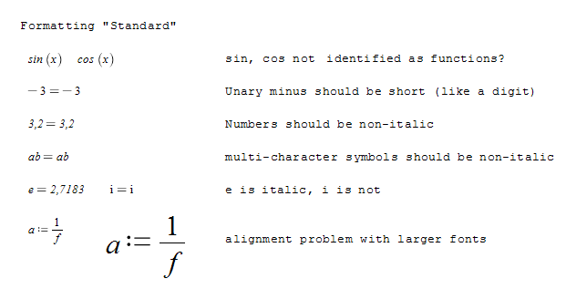

Some issues with higher font sizes:

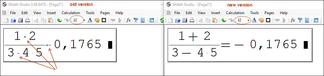

Ive experienced some strange font scaling issues in in the two latest builds (using the latest right now). As I change the font size using either the settings menu or the toolbar option, the effect seems inversed and interacting with each other. Furthermore, they dont display the correct font scale value. As I press enter in the first image, one expects the typeface to get larger (from 7 to 14), yet the inverse happens. As I open the settings again, it displays a 10, and thus does not remember the latest changes. This effect doesnt appear to be linear, although its hard to notice when scaling.
The problem is not specific to any particular file, but occurs whenever I change font sizes, and persists through restart/new file.
