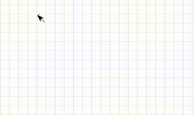

I would like to use the following input:
E=2,1*10^5 MPa
but after entering the value, I can't define unit (apostrophe button has no effect). So I tried using = sign. After it I can enter unit but here's what I get:
How to use scientific notation with units properly ?

Thanks, it seems that I can specify unit using apostrophe button only when the whole 10^5 term is highlighted:
Otherwise, this button doesn't work.
