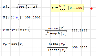

Dear Friends,
I tried to calculate the effective value of segmented voltage waveform, but failed, could you help me to fixed it? Thank you very mucn! RMS calc.sm (10.21 KiB) downloaded 806 time(s). image.png

Hi. This is a way. You can see also the file RMS in this post.
Also:
RMS-example.sm (17.81 KiB) downloaded 725 time(s).

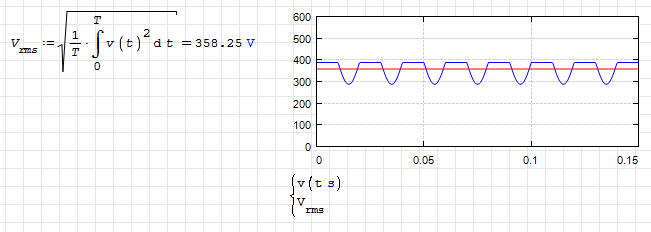

#3 Posted: 12/10/2025 9:55:31 PM
1,357 likes in 2,271 posts.
Version without killing the units:
RMS-example.sm (8.29 KiB) downloaded 737 time(s).
In the original version, just making the periodicity function unit-proof, is sufficient:
