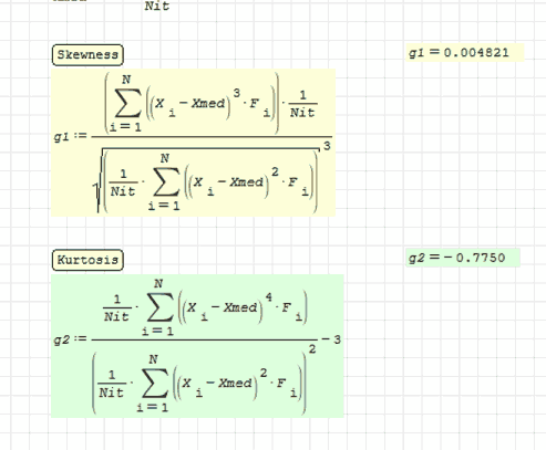

#1 Posted: 5/28/2018 1:32:09 AM
Stat Skewness(Y).sm (10.82 KiB) downloaded 1409 time(s).
#2 Posted: 5/28/2018 1:46:01 AM
... kurtosis does not cut the mustard either.
Stat Skewness(Y).sm (12.95 KiB) downloaded 1410 time(s).

I have the same problem with latest SS appVersion(4)="0.99.6671.38791".

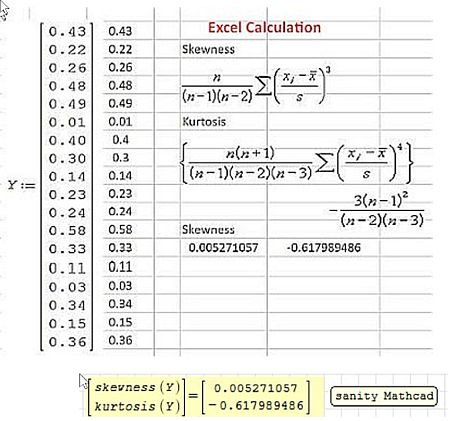

Thank you Jean for highlighting this issue.

Forgot to attach the Excel worksheet. Sorry!
Skew & Kurtosis.xlsx (24 KiB) downloaded 955 time(s).

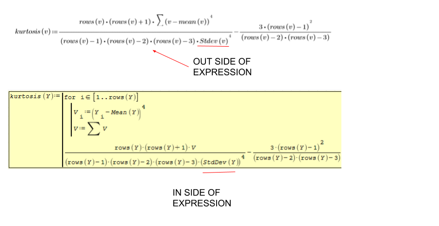

Source code: Mathcad/Mathsoft "Statistical Electronic Book"
I may have found the issue. Not sure if there is a typo or not in your book, but if you look at the Mathcad Website here: https://help.ptc.com/mathcad/en/index.html#page/PTC_Mathcad_Help/example_kurt_and_skew.html
You will see a formula similar to yours. However, you need to move the StdDev(Y) function outside of the left most expression in each function. I'm not at a computer with Smath right now so I can't verify if it produces the same results. Will check back later.
That is immaterial, the suite of multiplications is commutative.
Smath/Matlab use the same Kurtosis algorithm ... different than Mathcad.
OriginLab 7.5 [formerly Microcal] gives 19 stat parameters wrt to 'Y'
OriginLab 7.5 kurtosis = same as Mathcad [-0.618]
Note that OriginLab is the Bible CAS in Pharmacokinetics.
Smath KurtosisExcess(Y)=-0.775 is much closer ... still troubling.
Yes. but (a*b*c)^4 is much different than (a*b )*C^4 Edit: Whoops I see that it looks right in original file. I miscounted parentheses.

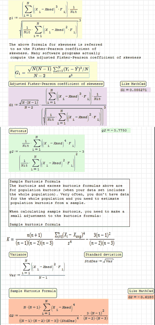

I've done quite a bit of research into this because I've been curious. There are two differences between the Matlab/Smath and Mathcad Functions.
1.) The Matlab kurtosis link mentions this, but the Wolfram link explains it very well. Kurtosis has been historically defined such that a normal distribution has kurtosis of 3. However, Kurtosis Excess is defined with a -3 offset such that a Normal distribution has a Kurtosis Excess of 0. The Mathcad Kurtosis function is really a Kurtosis Excess function such that a normal distribution has a kurtosis of 0.
2.) The second difference is that the Mathcad algorithm accounts for sample size whereas the Matlab/SMath algorithm does not. I found a website here that explains the difference.

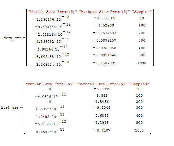

Lastly, I performed a small experiment by creating a Matlab based skewness and kurtosis function as well as a mathcad based skewness and kurtosis function. I then created random vectors with increasing sample sizes (from 10 to 1000) and compared the % error from the built in Smath Skewness and Kurtosis functions. As you can see the as the sample size increases the difference between the Matlab and Mathcad algorithms decreases (at least for Skewness). It may take a minute or two to run.
Stat Skewness(Y)_Lyles.sm (31.17 KiB) downloaded 1407 time(s).
#11 Posted: 5/30/2018 6:18:16 PM
CBG
CBG
78 likes in 312 posts.
Skewnesss_and_Kurtosis_Jean_CBG.sm (11.18 KiB) downloaded 1411 time(s).
#12 Posted: 5/30/2018 10:44:21 PM
Thank you both: Alyles, Carlos.
I reconciliated myself with these two descriptive statistic parameters.

#13 Posted: 5/31/2018 12:38:51 AM
CBG
CBG
Skewnesss_and_Kurtosis_Jean_CBG_R1.sm (46.88 KiB) downloaded 1408 time(s).
#14 Posted: 5/31/2018 11:05:56 AM
Thanks Carlos for your reconciliation ... no more bug !
Stat Skewness_Kurtosis(Y).sm (60.54 KiB) downloaded 1508 time(s).
