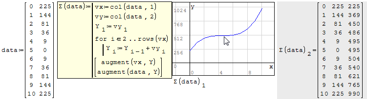

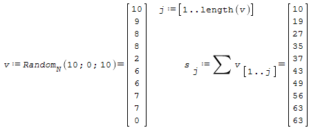

In the attachment at the start of Page.5 I (so far) am unable to construct a loop or something that cumulatively adds vector elements down the column. So I am manually doing this for now, any ideas?
I have started additions from the 6th element because first x4 were zero ...but I think you get the idea!

no no ...I think I was unable to make you understand. The summation gives one value ...instead I wanted to have a cumulative elements in a vector. The latter thus can be plotted. please revisit the screenshot

Sum the vectors and vectorize ...

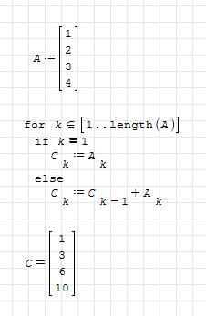

Jean,
Why did you use Sum(1) with a J loop?
Ioncube,
Just use Sum(4)

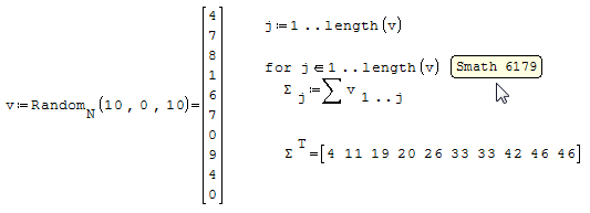

#14 Posted: 4/24/2018 12:11:37 AM
mkraska, thanks for helping, but your file is created with a newer version of SMATh
You are right: Martin latest version throws error in my 6179.
I love Martin code ... Bingo !
The code I provided should work, as it did previous Smath 5346.
#15 Posted: 4/24/2018 12:28:22 AM
Try that in your version.

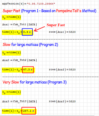

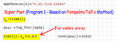

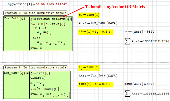

I tested 3 programs to find the cumulative totals of a large array of 20820 elements.
The method of Sergio was incredibly fast, while other two methods were much slower.
Thanks Sergio.
Forgot to attach DATA file
Rainfal_Data.xlsx (486.31 KiB) downloaded 772 time(s).
Cumulative Sum of a Large Matrix.sm (30.38 KiB) downloaded 1130 time(s).

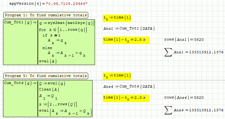

Hi Nugegodage. Try this other one.
Cumulative Sum of a Large Matrix.sm (25.32 KiB) downloaded 1399 time(s).
(Notice that mi computer is very slow)

Hello Alvaro
I get following result in my laptop.
Yours is a very good alternative.
Thanks.

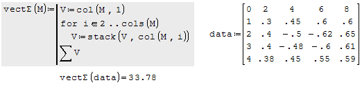

1. Unwrap the array in vector
2. ΣV ... vector sum over the unwrapped array
SS 6179 does not open your document.

...more and otherwise.
vectSum.sm (15.92 KiB) downloaded 1277 time(s).
