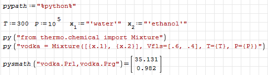

#2 Posted: 12/25/2021 6:44:37 PM
1,558 likes in 1,868 posts.
I think we can think of something. For example, it might look like this.
