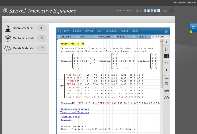

Knovel, a provider of technical e-books with added interactive features has released an integrated math tool which is obviously based on SMath Studio. Even if there is no hint to Andrey or SMath on their web page, the tool cannot hide it's SMath Studio origin.
You find it at http://tools.knovel.com/ie
It is basically an improved version of SMath life and can be accessed after you register on the Knovel website (it is free). The screenshot shows an uploaded page from my interactive handbook, just as a proof of compatibility.
If you hesitate to register, you still can access the help resources under http://tools.knovel.com/ie/Help/Main.htm .
They have a nice beginner's manual and a set of videos.
I have some problems operating the program, single quote and left paren are not working, also the response is a bit delayed. The function palette bugs with int() and diff() inserting the useless one-argument versions are final proof that the same engine is at work as in SMath Studio ;-)
