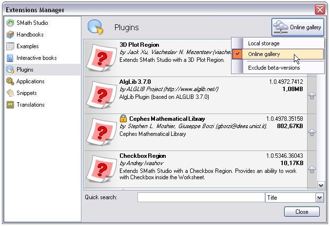

If SMath is installed in your system, you should be able to install any extension even without system permissions.
Go to "Tools" > "Plugins..." > "Online Gallery" and download the plugins you need. They will be installed in the %APPDATA% folder (C:\Users\\AppData\Roaming\SMath Studio in windows 7).
If you have big permissions issues it is possible to use a portable version (here one)
