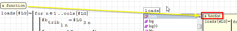

I use #var for "local" variables, so any other variable is "global" (loads is not only function of LG, also of LF.DL etc...); I strongly suggest to use some trick like this, for a fast and easy debug/maintenance (you can use #var _var `var Var VAR or whatever is the best way for you... to add the # symbol before the word, write the word and then move the text cursor to the first character and place the symbol)
About functions remember these rules:
- any variable created inside the function is 'local';
- you can get variables from outside the function, if doesn't exists inside the function;
- if you define a new value for an input argument, this is global (affects the input variable outside the function) (this is called "passing by reference", if I remember correctly the official name of this feature)
In your worksheet, when you define [math eng]el(b.trib,1)[/math] inside the function, SMath as first thing attempts to replace the first matrix element; because doesn't exist yet as local variable, Smath looks in the worksheet for a global variable: if exist will be used as base inside the loop (and here you are back to the issue of the first post), otherwise initialize an empty matrix. Using a name "hardly utilizzable on the canvas", you skip any issue.
As you can see copying a not filled function from SMath to a text editor, # is used as empty placeholder; this is why you can't write directly a variable using # as first character
Best regards,
Davide
P.S. the dynamic assistance show you that loads is a function; however you can set a description text to point out this fact.

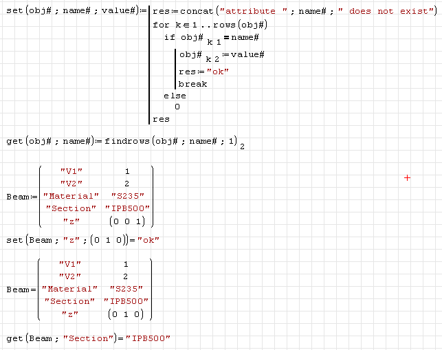

This would work. The disadvantage is that you cannot use ordinary SMath sheets as function descriptions. Instead, you have to write sort of
program (using the line() operator) to do the job.
Before designing the functions you perhaps might consider to define
- the problem data structure and methods to apply to this data structure
- methods data structure like tables, only accessed within the methods
Both structures can be just global variables or single complex objects. You can fake objects with named attributes by using a 2-column matrix with name strings in the first column and whatever object in the second column and define a corresponding set(structure,name,value) and get(structure,name) function pair.
Functions can provide return values and can modify arguments, if these are given as names (call by reference). They cannot modify global variables (any assignment to a name which does not occure in the formal parameters list creates a local variable, shadowing global objects of the same name).

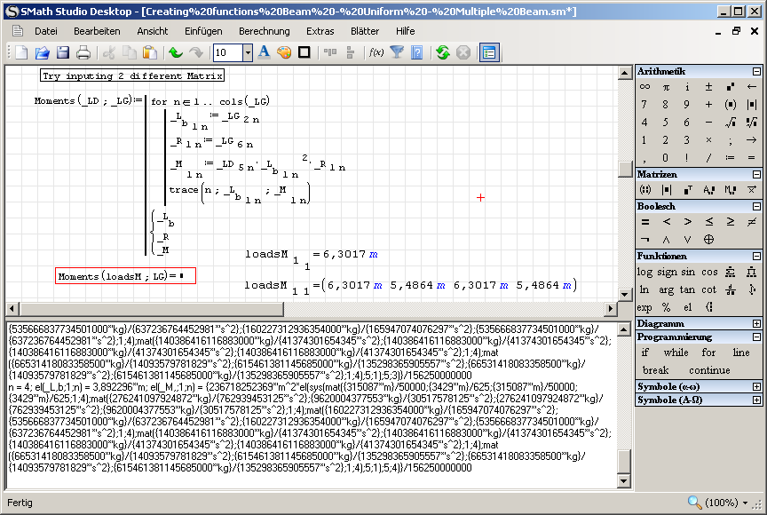

Thanks for the response and explination. I seem to have an error when trying to replicate. "Argument doesn't match to expected kind"
Error in Accessing System
#15 Posted: 5/15/2014 11:10:03 AM

Very interesting -> my problem was that if you type:
loadsM[1[1
Then you receive an error
if you type:
loadsM[1spacebar[spacebar
Then I receive the correct result

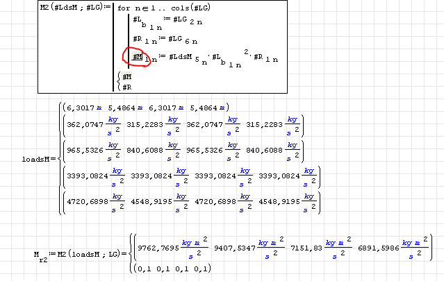

Here is an updated calc show some different options, for anyone else who comes across this.
There is one interesting error however which is that it returns one of the matrices as undefined (see attached).
Thanks!
Creating functions Beam - Uniform - Multiple Beam.sm (72.2 KiB) downloaded 1506 time(s).
#18 Posted: 5/15/2014 12:36:23 PM
1,359 likes in 2,273 posts.
Thanks!
You are victim of bug SS-40. Andrey has marked it as fixed but did not yet roll out the fixed version.
You can identify such problems by setting the cursor on some name and watching if all occurences of that name are highlighted in the expression. If not, then there might be a typo or a hidden empty text index.
See the marked spot in the attachment and compare this to your original file.
