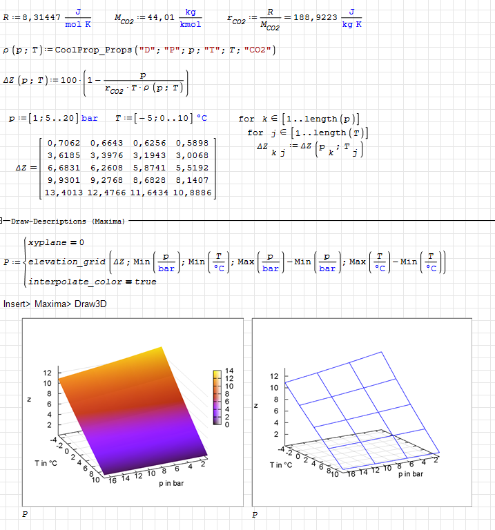

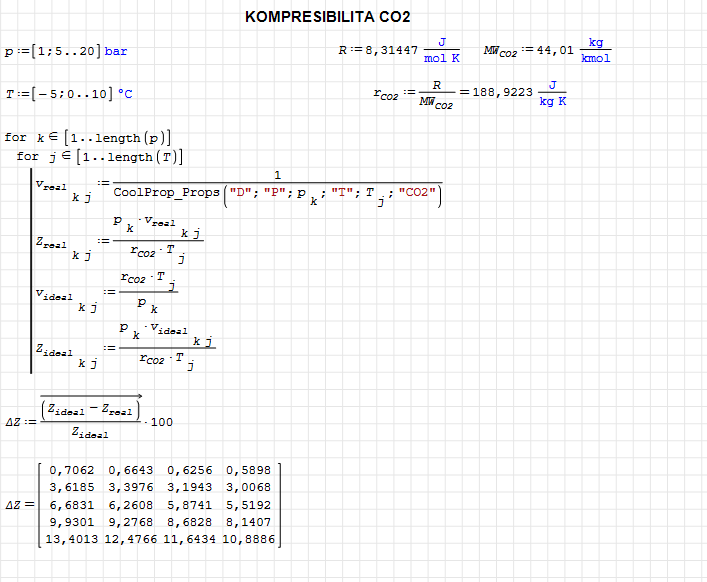

i would like to create 3d plot of compresibility with p and T as axis. How can i do that?
Thanks,
Tomáš

Hi. This is a way.
Z-CO2.sm (16.56 KiB) downloaded 890 time(s).
Edited 12/14/2025 5:15:11 AM

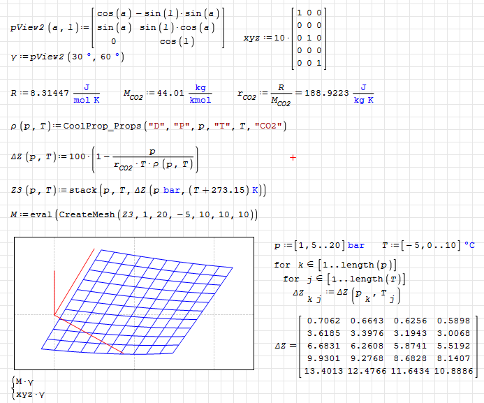

#6 Posted: 12/17/2025 10:17:20 PM
1,361 likes in 2,275 posts.
The plots can be rotated with the mouse, yet there is a considerable time lag.
3d.sm (219.19 KiB) downloaded 860 time(s).
Edited 12/17/2025 10:18:37 PM
