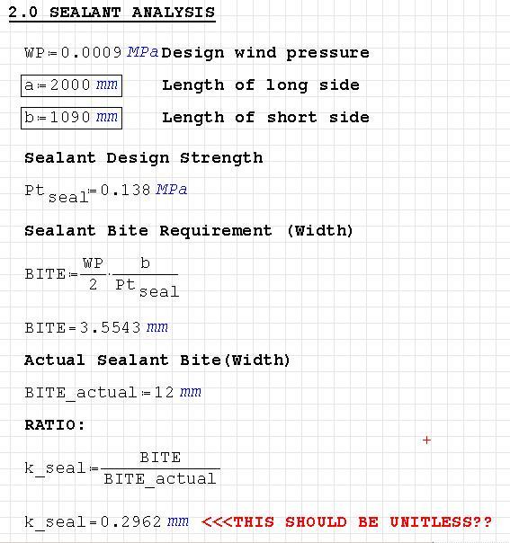

when similar units are divided the result does not cancel the unit
please help and see attached file.

Hi megamaxx,
you have forgot the unit in the BITE_actual definition (see the attachment)

I tried your example and got the unitless value, as it should be.
Could you attach your *.sm file, please.

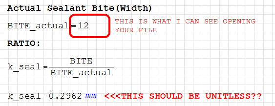

from wath I can see from your *.sm file, you simply forgot the unit in BITE_actual (see the attachments), but I can't reproduce the issue in your image...

w3b5urf3r & omorr,
Thanks I appreciate you guys looking up on this matter.
It's a bit strange for me since the file and the attachment does show the BITE_actual=12 (without the mm) as w3b5urf3r commented.
Apologies for the trouble, I'm having a hard time how to replicate jpeg image right now as I encode my calculation template...hmm, makes me doubt myself in a way.

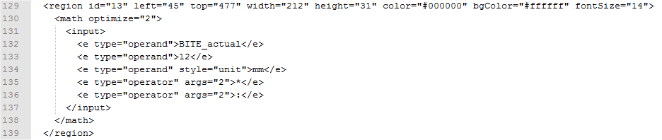

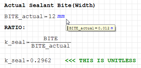

Hi
I can't replicate the issue but now I can confirm that there is something strange
In the attachments there are:
1) the source of your file as downloaded
2) the source of your file opened by SMath studio and saved on my PC
3) the correct source
I do not know how did your SMath create the script:
mm
regards,
w3b5urf3r

#10 Posted: 8/12/2012 3:35:18 PM
2,345 likes in 4,059 posts.
Many thanks for the bug report and for troubleshooting!
I've reproduced a bug. See animation for details. Wil fix this.
