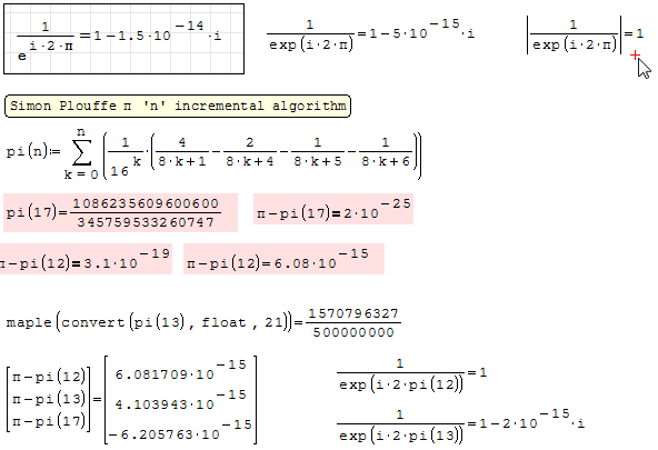

This is maybe not a bug but it doesn't look very well.
Result should be pure real 1
I understand why this happen and wonder if that fixable

1. your expression is incorrect: Euler 'e' is a number
2. as it should be '1' but not computable it displays complex.
3. often, annoying but |abs| makes it computed.
4. some ancient MainFrames still have pi in numerical values [XXX decimals]
5. Advanced computing machinery use "Simon Plouffle".
6. NOT a bug: just a fact not yet fixable [expect more from Smath Geeks].

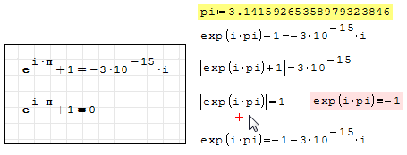

Hi Kriss. You're right. It's a shame that the result isn't exact.
This was call the most beautiful equation, because relates the most important numbers in the history, which came from different disciplines: calculus, geometry, complexes and natural numbers.

Thank you! Fixed in the latest beta: https://en.smath.info/forum/yaf_postst14958_Beta--SMath-Studio-0-99-6877--30-October-2018.aspx
