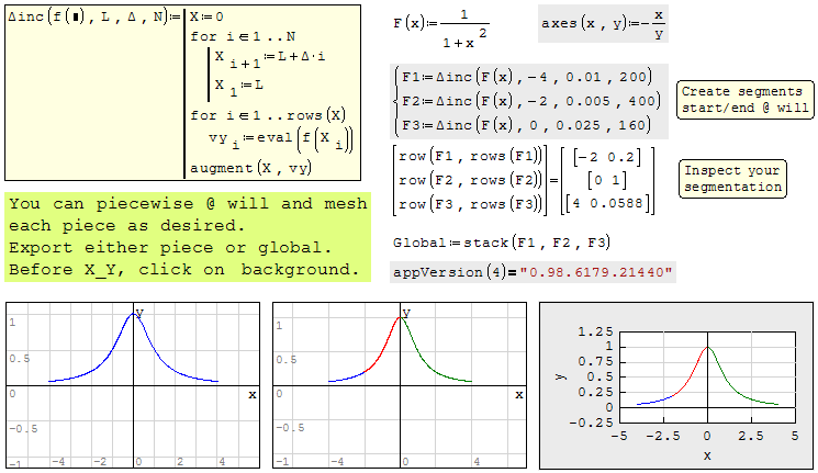

#1 Posted: 6/3/2021 11:05:00 AM
As much it looks innocent/over-killed, it is not.
Assume your project has steep entrance/departure,
Simpson integrator is most likely uncertain, or fails.
especially on long range of the variable of integration.
At this point, from wisely populated, integrate FD.
FD = Finite Differences.
Utilities Discrete fmesh COMPANION.sm (16.94 KiB) downloaded 1459 time(s).
