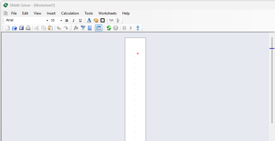

Why the first screen/file is like the picture?
What can I do?
Thank you,
Basile
#2 Posted: 6/26/2026 4:44:18 PM
2,345 likes in 4,059 posts.
Please check the Page Setup dialog in the File menu.
You can change paper size there.
Does it help?

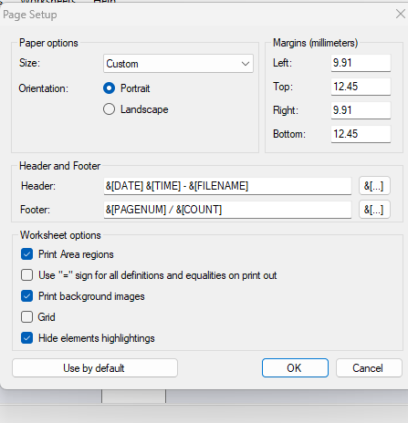

#3 Posted: 6/26/2026 10:30:26 PM
Basile
Basile
0 likes in 2 posts.
Hello Andrey, and thank you for the reply.
When the program starts for the first time, it uses "Custom".
When I changed to "Letter" and save as a default, then the usual square background appears, and it is saved in the next time.
Thank you,
