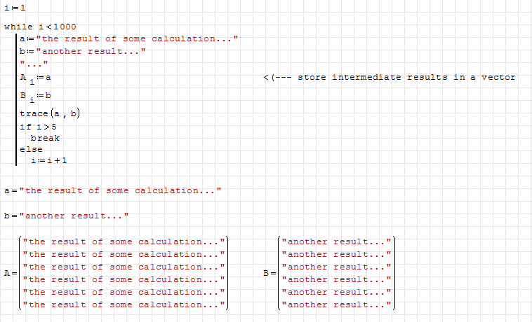

Hello cartographer,
If you don't need to store intermediate results, you can use a standard while loop like the attached.
trace() function (wiki:trace) in this case helps a lot to debug.
In the other hand, if you need the collection of the values at any loop, you can use vectors/matrices to store the results.
Best regards,
Davide
P.S. Use numeric optimization to speed up calculations
![2014-07-21 15_56_27-SMath Studio Desktop - [while.sm_].png](/en-US/files/Download/6y8zmX/2014-07-21-15_56_27-SMath-Studio-Desktop---[while.sm_].png)

#3 Posted: 7/21/2014 10:27:52 AM
The code requires use of "while" loops within which to converge iterative elements of the math in each case. The problem is that it is necessary to get at the final values of several parameters that are used within the loops (6 in one case and 10 in the other) once convergence is complete. These values are then used for further, post convergence, calculations.
If you just need a final set of values (and not the iteration history of the values) this is trivial for canvas-level loops, as the variables just have their last values and are visible outside the loop.
If the loop is part of a function body (right hand side of a function definition) then there are two ways to convey the result to the outer namespace:
- put the values in a vector or list and make that list the last instruction in the function body (return value).
- use assignments to function parameters
loop.sm (7.85 KiB) downloaded 1600 time(s).

#7 Posted: 7/23/2014 6:19:27 AM
Hello Michael,
It seems here is a "standard" problem we bumped into (again).
Just right click on the while loop and choose Optimization->Numeric. Then you will get the results. This is advisable when you have only numerical calculations.
