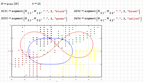

SMath Forum SMath Studio Questions Roots portrait 1 Pages (2 items) Roots portrait - n=10-20 OK, n>20 not OK - Messages Go to last post #1 Posted: 8/14/2023 2:58:55 AM Valery Ochkov 67 likes in 716 posts. Group: User See please the attachn=10-20 OK, n>20 - I can not get the answer.More about this taskhttps://www.mdpi.com/2227-7390/10/19/3413Roots-Portrait.sm (36.08 KiB) downloaded 1408 time(s). #2 Posted: 8/14/2023 4:21:45 AM Alvaro 1,139 likes in 1,805 posts. Group: User Hi Valery. You need to add an eval for that.Also can try to use the Draghilev's method and Mathcad block using the library in this post.DraghilevSolveBlock-Tolstoi.sm (269.54 KiB) downloaded 1491 time(s).Best regards.Alvaro 1 users liked this postValery Ochkov 8/14/2023 6:33:00 AM 1 Pages (2 items) New Posts No New Posts
