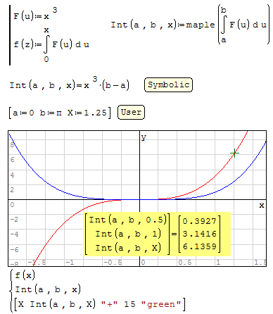

Personally, I like the way it was 5346 still 6179 latest release.

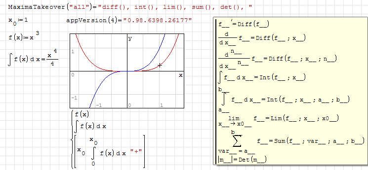

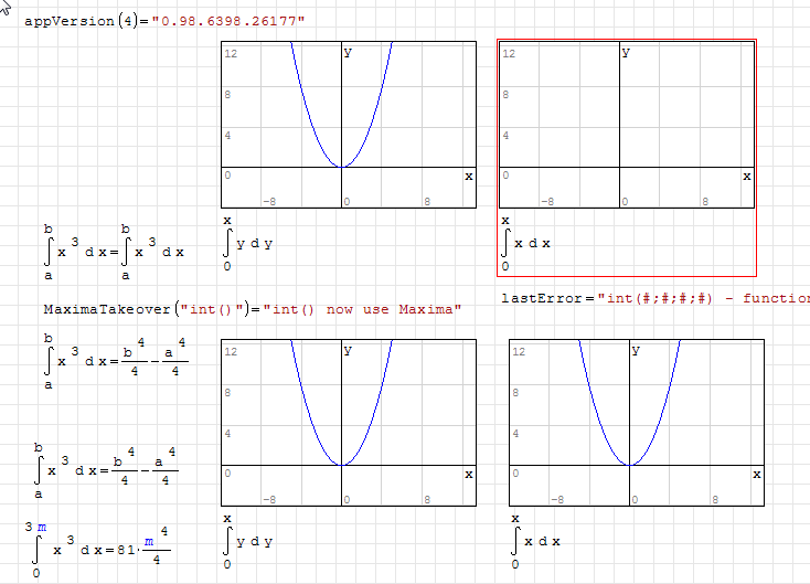

I implemented a new MaximaTakeover() function, which adds definitions to the context or removes them according to the given arguments. First tests seem very promising, such that the full functionality of the Maxima plugin can be re-established soon.
It turned out that something like
int index;
if (context.Contains(lhs, out index) context.RemoveAt(index);
didn't do the job of deleting the definitions from the global context. The deletion actually worked (as per inspection in the debugger) but that was of only local scope. I had to resort to Clear().

#7 Posted: 7/29/2017 9:19:33 PM
1,359 likes in 2,273 posts.
I like it this way...
Don't know, however, if it is safe to remove the ugly underscores from the variable names...

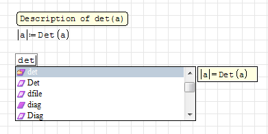

I'd like to provide a standard description to the definitions created in MaximaTakeover().
Currently, the descriptions simply show the definition (as can be seen in the previous post).
The idea is, to get the description of the Maxima function (Int(...) and add it as description to the generated definitions, perhaps with some adjustments (convert uppercase to lowercase in function names).
How would I do that?

You can use the AddDefinition(Definition value) method; Definition has some constructor with the description argument

#11 Posted: 8/1/2017 8:06:09 PM
Thanks. Davide.
First, I tried a very compact way, but that didn't make it beyond the current math region.
                    // add definition
                    Entry rhs = Entry.Create(TermsConverter.ToTerms(Function));
                    context.AddDefinition(lhs, rhs);
                    // add description
                    context[context.Count-1].Description =  "description of "+ LhsString ;
Then I used the approach proposed by you, unfortunately, the definition constructor requires a terms list to specify the arguments. I found no smart way to extract this list from the function definition strings. Thus the code looks ugly and bloated.
                    string name = LhsString.Split('('[0];
                    string[] vars = Regex.Replace(LhsString, @".+\((.+)\)", "$1".Split(',';
                    Term[] Tvars = new Term[1];
                    int i = 0;
                    foreach (string v in vars)
                        Tvars[i] = new Term(v, TermType.Operand, 0); i++;
                    context.AddDefinition(new Definition(name, Tvars, rhs, "description of "+name));
This approach didn't work either, I even could not see the descriptions being generated at all in the debugger.
And in the end, when trying to provide a description in a math region directly, this is ignored. For the moment I have to give up. This might be related to the target functions being special functions. Re-definition somehow slips through, re-description obviously not.
#12 Posted: 8/2/2017 4:53:58 AM
Hello Martin,
Confirmed. I've looked at the core code and I know why, I'll try to make ii possible.
