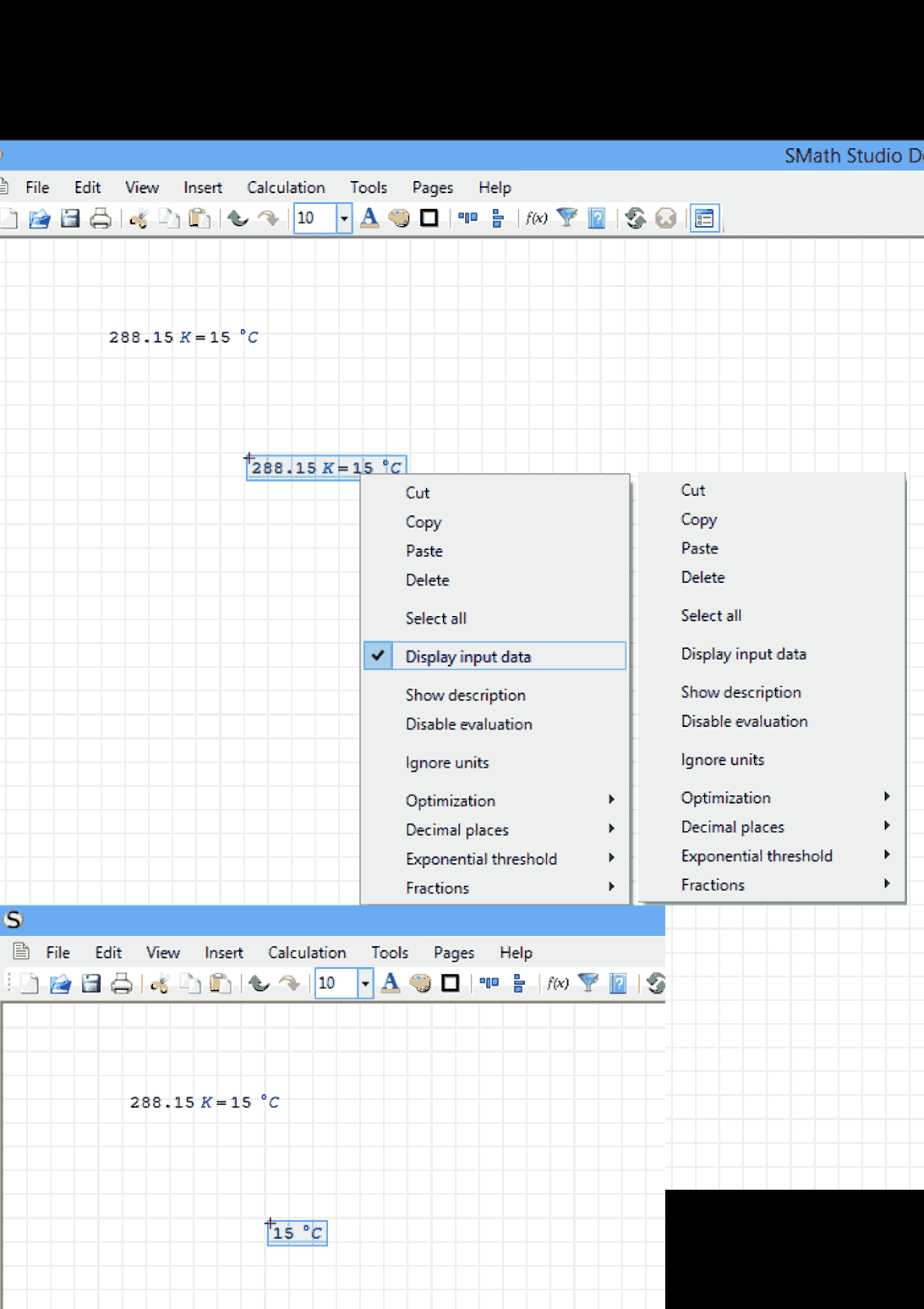

Currently, the custom units of result placeholder has scope of whole expression. So, e.g. trying to select result (15°C) in following line:
288.15*'K=15@'°C
results in whole expression being selected, not only part after "=".
If possible, please enable that selection, to make it easy to copy only result.

#2 Posted: 5/19/2016 9:24:02 AM
copy only result.
Maybe like this Mike.

#3 Posted: 5/19/2016 12:50:48 PM
2,343 likes in 4,055 posts.
Jean, I think Mike requests something like this:
Will check if it is possible to implement

#4 Posted: 5/19/2016 1:31:19 PM
CBG
CBG
78 likes in 312 posts.
Or something like this..

#5 Posted: 5/19/2016 7:02:30 PM
Implemented. Can be tested here: http://en.smath.info/forum/yaf_postst7566_SMath-Studio-0-98-5983--19-May-2016.aspx

#6 Posted: 5/21/2016 8:32:41 AM
Mike Kaganski
Mike Kaganski
184 likes in 434 posts.
Great!
In the same time, it made it more convenient to remove result with custom units, if I decided that I don't want to see the result at all with the expression.
Before, I needed to remove custom unit explicitly, now I just put cursor to the result and hit Backspace several times.
Thanks again!
