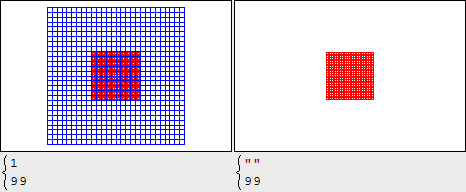

3dPlotBug.sm (1.8 KiB) downloaded 1375 time(s).
Attached is a simple file showing my problem, with a screen shot.

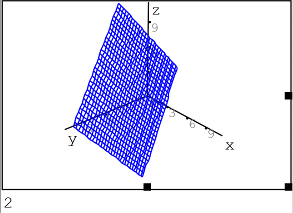

yes it is a known bug, you have to click the refresh button on the plot palette.
