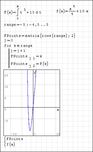

Here is the example of Definite Integral plotting by points:

Your example about plotting the function with definite integrals is quite understandable and this plot is right, but please take a look at your (correct) plot and the one I mentioned incorrect (the blue line represents F(x)). What is this about?

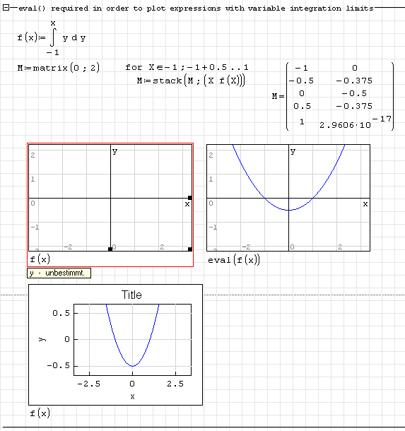

#20 Posted: 7/26/2013 6:17:28 AM
1,364 likes in 2,281 posts.
There still (as of 0.96.4909) seems to be a problem to plot functions involving definite integrals. You have to embed them into eval(), otherwise they give a useless error message (claiming that the integration variable is not defined)
The X-Y Plot plugin does not seem to have that problem. A workaround might be to apply eval() for expressions to be plot
by default. At least I am not aware of counter-indications.
