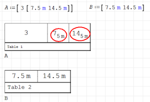

#1 Posted: 8/27/2023 5:58:19 AM
NDTM Amarasekera
NDTM Amarasekera
130 likes in 352 posts.
Hello !
I have this display problem when trying to pass
a matrix to a Table.
Table_Region_Problem.sm (11.47 KiB) downloaded 1579 time(s).

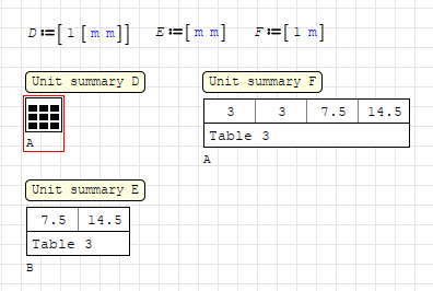

#2 Posted: 8/27/2023 9:11:12 AM
600 likes in 1,381 posts.
Unit summary doesn't work as it should either.
Maybe these are bugs. Regards

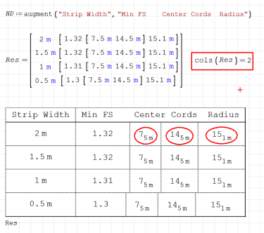

#3 Posted: 8/27/2023 3:07:33 PM
NDTM Amarasekera
NDTM Amarasekera
Hello !
My post #1 is a simple example to show the Table Region problem.
The actual problem is related to a Slope Stability Analysis example,
where the result consist of the following.
1. Strip width
2. Relevant Min Factor of Safety (Min_FS)
3. Center cordinates (x,y) of slip circle relevant to Min_FS
4. Corresponding Radius of slip circle.

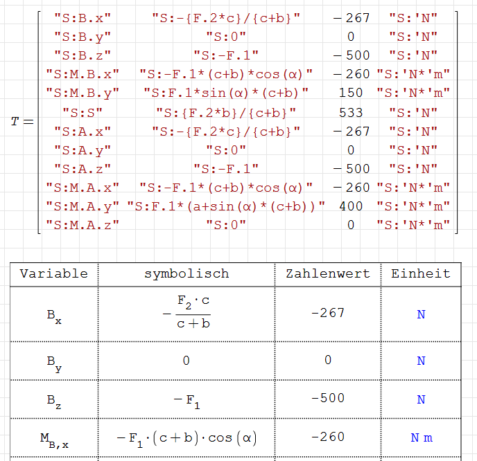

#4 Posted: 8/28/2023 4:31:21 AM
1,361 likes in 2,275 posts.
In the attached sheet I tried to automatically compile a results summary. Note that there is a single entry point for unit specification in the algorithm (no chance for mismatch between displayed unit and unit used to calculate the numerical values.
1-3.sm (137.75 KiB) downloaded 1566 time(s).
#5 Posted: 8/28/2023 7:53:00 AM
At post #3 construct the matrix as independent cols, thus compatible Table.
Next, nest the two pertinent cols to explicit your Engineering c/w header.
