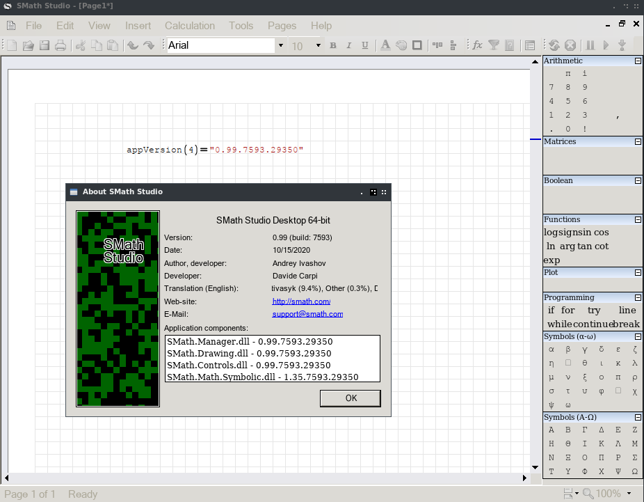

This is how it is on my setup.
Same as previous builds.
#26 Posted: 10/15/2020 11:15:34 AM
2,345 likes in 4,059 posts.
Hmm, then this is not because of incorrect image...

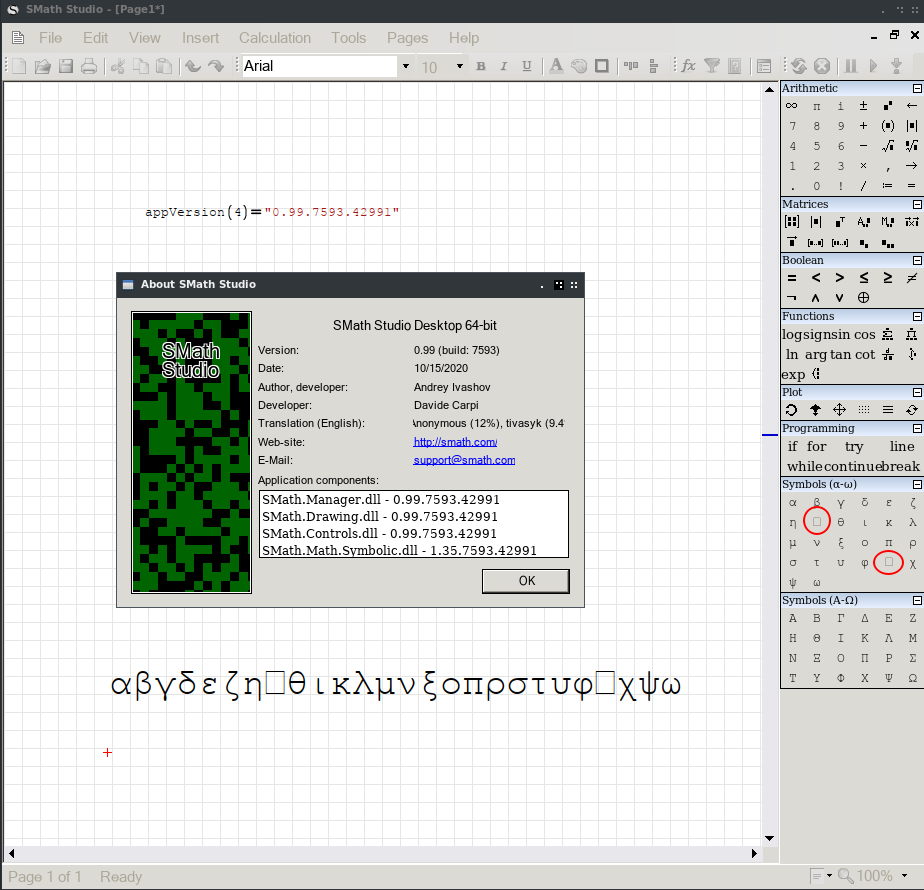

All is working excepts those two characters.
Congrats, a long mystery is solved.
This is because of Font missing some Greek symbols. Please try to write these chars in TextRegion and test different Fonts for this Region. I'm sure you will find some Fonts which will allow to render all Greek chars correctly.

Great! Thank you!
Yeap, you were right. I have copied courier font from windows font folder to linux now everything is in order.
Apparently free courier fonts are missing some characters. (which had derived from a previous archlinux setup)

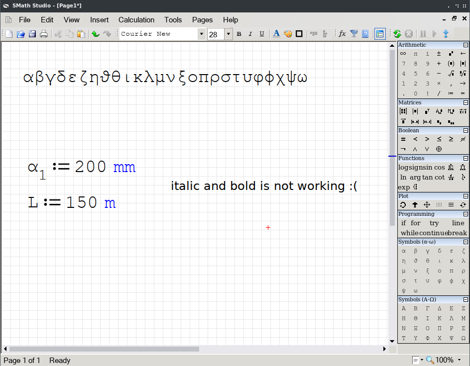

Well, because I have grumpy and complainer personality I have seen another problem.
Bold and italic (and combined) is not working also.
Expressions should be italic and greek characters above is bold actually.
You can see this issue at picture below.
Regards.
