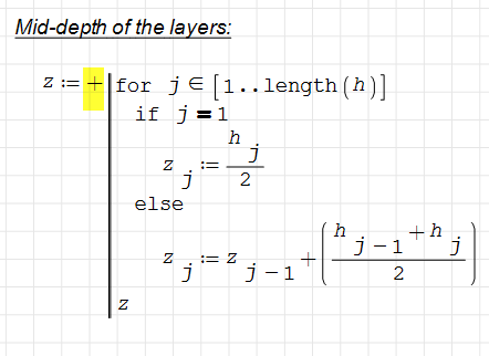

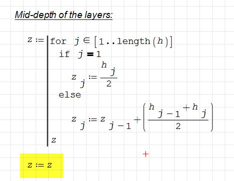

#2 Posted: 12/20/2023 12:50:59 AM
select all > optimization > numeric
AND EITHER
z:z
OR
z:+line(...)
This is because z:line() is a procedure (something like a function, but for variables); it doesn't evaluates in place on definition, hence is completely calculated from scratch every time you need z, z[j], etc....
Using a + between the definition operator and the line() function, you don't have anymore a procedure; using z:z, it evaluates once from that point onwards.
Seismic Site Class & Liquefaction Potential_num.sm (124.85 KiB) downloaded 1461 time(s).

#3 Posted: 12/20/2023 1:01:15 AM
Perfect, that works!
Much appreciated as always!

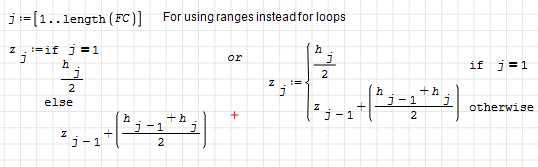

Hi. You can eliminate all the for loops using the SMath index vectorization, which work more or less like the same concept in matlab, with cases() for having some visual separation
Seismic Site Class & Liquefaction Potential v2.sm (119.62 KiB) downloaded 1517 time(s).
