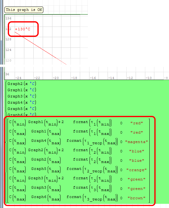

I cannot force 2D graph to show labels that I prepare in a variable.
Here are the screenshot of normal view, made when I construct labels in input data area:
You may see that there is a label near line end.

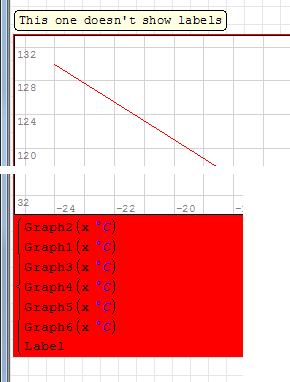

When I put the labels in a variable, and try to display the result, I see no labels:
Here is the file:
temp.sm (50.01 KiB) downloaded 1321 time(s).Could you please help me understand what I do wrong?
