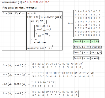

I remember there were some useful posts to find the positions in an array
satisfying defined conditions.
Another approach is attached.
Array_Pos2.sm (15.2 KiB) downloaded 1741 time(s).
