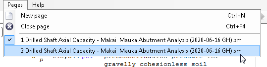

WroteVery strange... It is possible that you had the same file opened twice in the same instance?
That is the right answer, common mishandling.
#5 Posted: 7/3/2020 4:10:28 PM
Thank you both for your help! I will not make this mistake again
