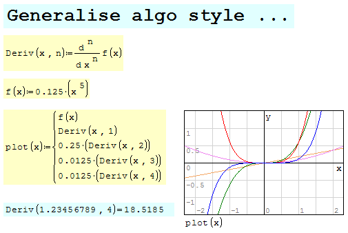

#3 Posted: 1/9/2023 12:37:18 PM
...make it algo style for in-situ command line.
#4 Posted: 1/9/2023 1:19:06 PM
Maths Derivative GENERALISED algo.sm (9.37 KiB) downloaded 1727 time(s).

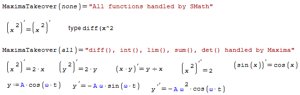

#5 Posted: 1/9/2023 3:02:06 PM
1,362 likes in 2,276 posts.
SMath has a built-in prime operator ()'. It can be created but will not be evaluated in the base configuration of SMath Studio
The Maxima plugin links this operator to the function Diff(1), which computes the total derivative of an expression with respect to all variables in that expression. You can mark symbolic constants in the expression by making them custom units (writing them with a leading prime like 'y).
The function Diff(1) is always avaliable if the Maxima plugin is installed, yet the operator form must explicitly be "hijacked" by the command MaximaTakeover().
It is then available as diff(1) in the dynamic assistant.
You can create second derivatives using nested ()' operators but that doesn't look good. Perhaps appropriate operators could be defined in the custom glyphs plugin.
diff1.sm (8.03 KiB) downloaded 1809 time(s).

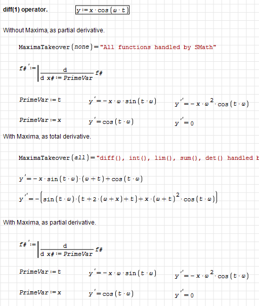

#6 Posted: 1/9/2023 6:56:03 PM
1,139 likes in 1,805 posts.
Hi. Some notes.
SMath has a built-in prime operator ()'. It can be created but will not be evaluated in the base configuration of SMath Studio ...
You can assign it to a partial derivative like operator inside SMath. (First example in the image)
... The Maxima plugin links this operator to the function Diff(1), which computes the total derivative of an expression with respect to all variables in that expression. You can mark symbolic constants in the expression by making them custom units (writing them with a leading prime like 'y).
Maxima is a great plugin. You can have it and prime as partial derivative, this is, it is not necessary to use units to mark variables other than the variable of the derivative. (Last example in the image)
diff1.sm (20.62 KiB) downloaded 1799 time(s).

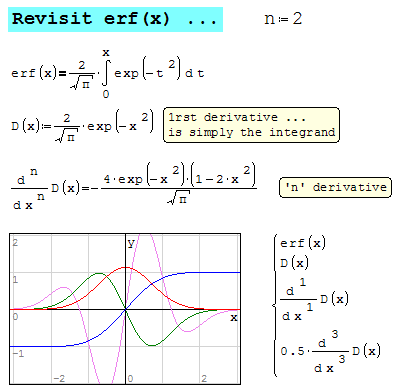

Hi Jean,
Thank you for the detailed examples. But how do you input the "n" on the top?
#8 Posted: 1/9/2023 10:30:08 PM
netsonicyxf
netsonicyxf
2 likes in 79 posts.
@mkraska, @Razonar
Thank you for the exaples.
So I can use nested 1st order derivative to get higher order derivative.
#9 Posted: 1/9/2023 11:03:19 PM
Hi Jean,
Type n at bottom, top follows automatically.

Maths Derivative GENERALISED algo.sm (9.37 KiB) downloaded 1743 time(s).
