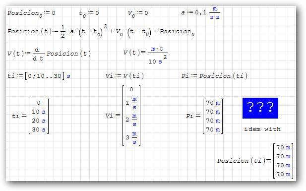

vector incorrect?
vector incorrect? - The values of the Pi vector, calculated for the previously defined function are invalid - Messages
#1 Posted: 8/16/2018 9:48:04 AM
Puma3D
Puma3D
0 likes in 3 posts.
However, by analyzing the individual values
any solution?

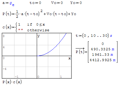

You must use the "vectorize" function to execute the operation element by element of the vector "ti"

Cannonball project ...
Maths Cannonball Copy.sm (28.19 KiB) downloaded 1315 time(s).
