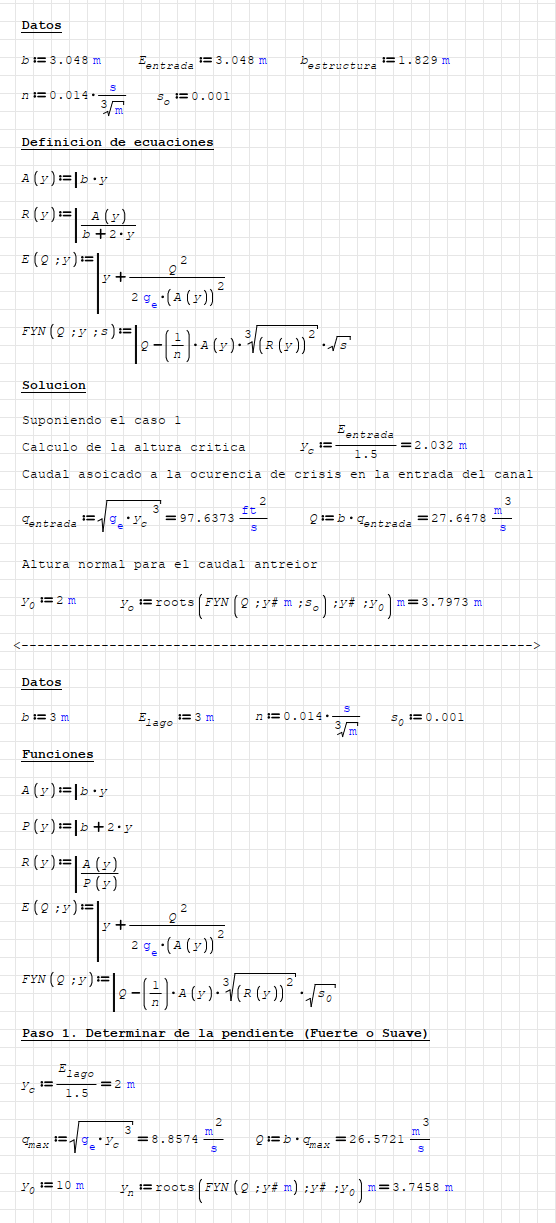

I need to pass these codes that are in Mathcad Prime to Smath, does anyone know how I can do it?
#2 Posted: 12/20/2021 3:19:50 PM
1,558 likes in 1,868 posts.
There is currently no converter from .mcdx format to .sm. And there is no one to do it, although it is possible.

#7 Posted: 12/20/2021 4:08:32 PM
600 likes in 1,381 posts.
Not same, but very similar.
calculo.sm (22.39 KiB) downloaded 1237 time(s).

#8 Posted: 12/21/2021 12:05:20 PM
But the programming is the same in Smath ?
I mean, for example the FYN or root function still works ?
Smath has many solvers. FYN from implicit roots(,,,).
roots will solve on the canvas [MACH number]
calculo Direct Code.sm (20.59 KiB) downloaded 1192 time(s).

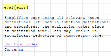

In short line | is a descending dependent collection.
Welcome to Smath Community ... Jean.
chito.sm (51.93 KiB) downloaded 1145 time(s).

#18 Posted: 12/23/2021 11:45:18 AM
Thank you for the very warm welcome, Jean.
Is there a reason why Dy is within in eval()?
I tried removing it in the function and the result looks the same.
Two typos in your 'chito' document: Manilla, Kota Kinabalu in Sabah.
You are right, no need to Dy:=eval(,) is so fast.
eval(,) applies to parse result as a numeric entity.
It breaks the chain calculation. Per application experimental.
The rule eval(,) is crucifying ... watch the demo attached.
from 65 s down to 0.015 s !!!
Take care ... Jean
Maths eval(,) TEST.sm (19.27 KiB) downloaded 1160 time(s).
