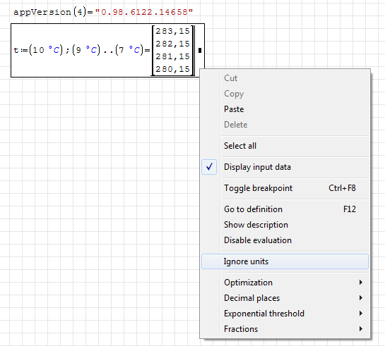

Units are lost in range(2):
С уважением, Михаил Каганский
Radovan Omorjan 10/6/2016 6:42:00 AM

#5 Posted: 10/6/2016 6:42:00 AM
Confirmed
#6 Posted: 10/6/2016 10:18:03 AM
Mike Kaganski
Mike Kaganski
184 likes in 434 posts.
Problems with "[", "]", "\" and units in range are fixed in appVersion(4)="0.98.6123.7493"
