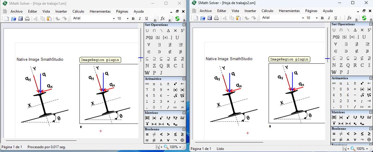

When I have already loaded an application in SMath and I want to load another application, the last one is always loaded as a new page and not as a new instance of SMath.
Sometimes (only), I want that the new application to be loaded in a new instance of SMath instead of a new page. How could I handle this option.

Just start another instance of SMath first, then load the other application in that.

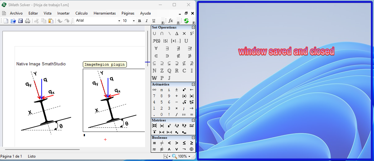

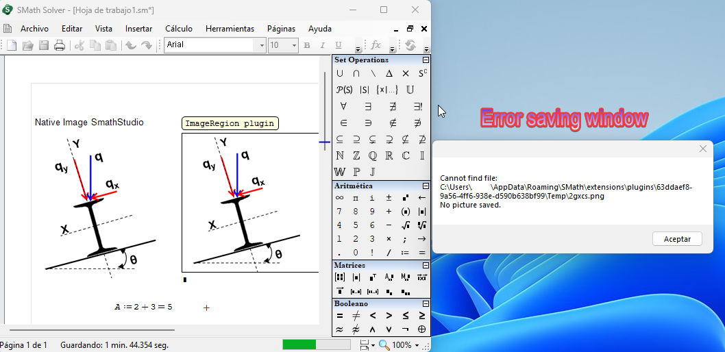

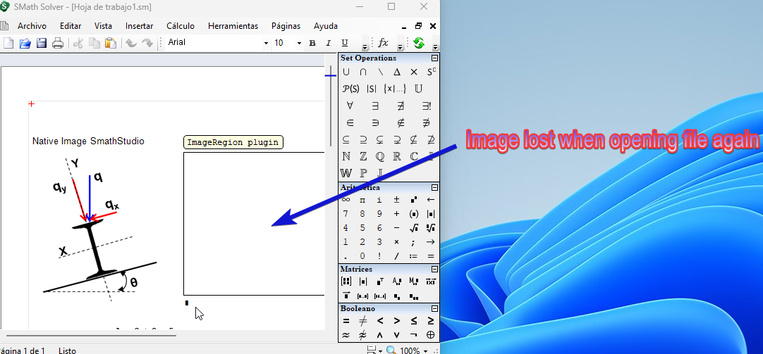

#4 Posted: 9/10/2024 9:48:42 AM
oscar mauricio
oscar mauricio
1 likes in 10 posts.
I normally don't start two instances of the application because when closing one of the instances an error is generated in the images inserted with the ImageRegion plugin of the instance that remains open.

#5 Posted: 9/10/2024 2:54:33 PM
1,442 likes in 2,933 posts.
I've found where is the issue, I can fix it.
ioan92 9/10/2024 5:43:00 PM
#6 Posted: 9/10/2024 6:48:04 PM
Fixed. Seems that the Release manager doesn't work currently, so the plugin can't be updated, but the code is uploaded in the SVN.
The temporary folder that contains the images generated on the fly by the plugin now has a sub-folder for each instance of the program, therefore the issue shouldn't arise anymore (BTW probably it was already reported before).
